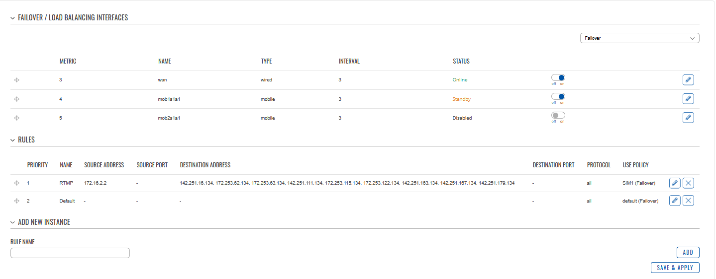

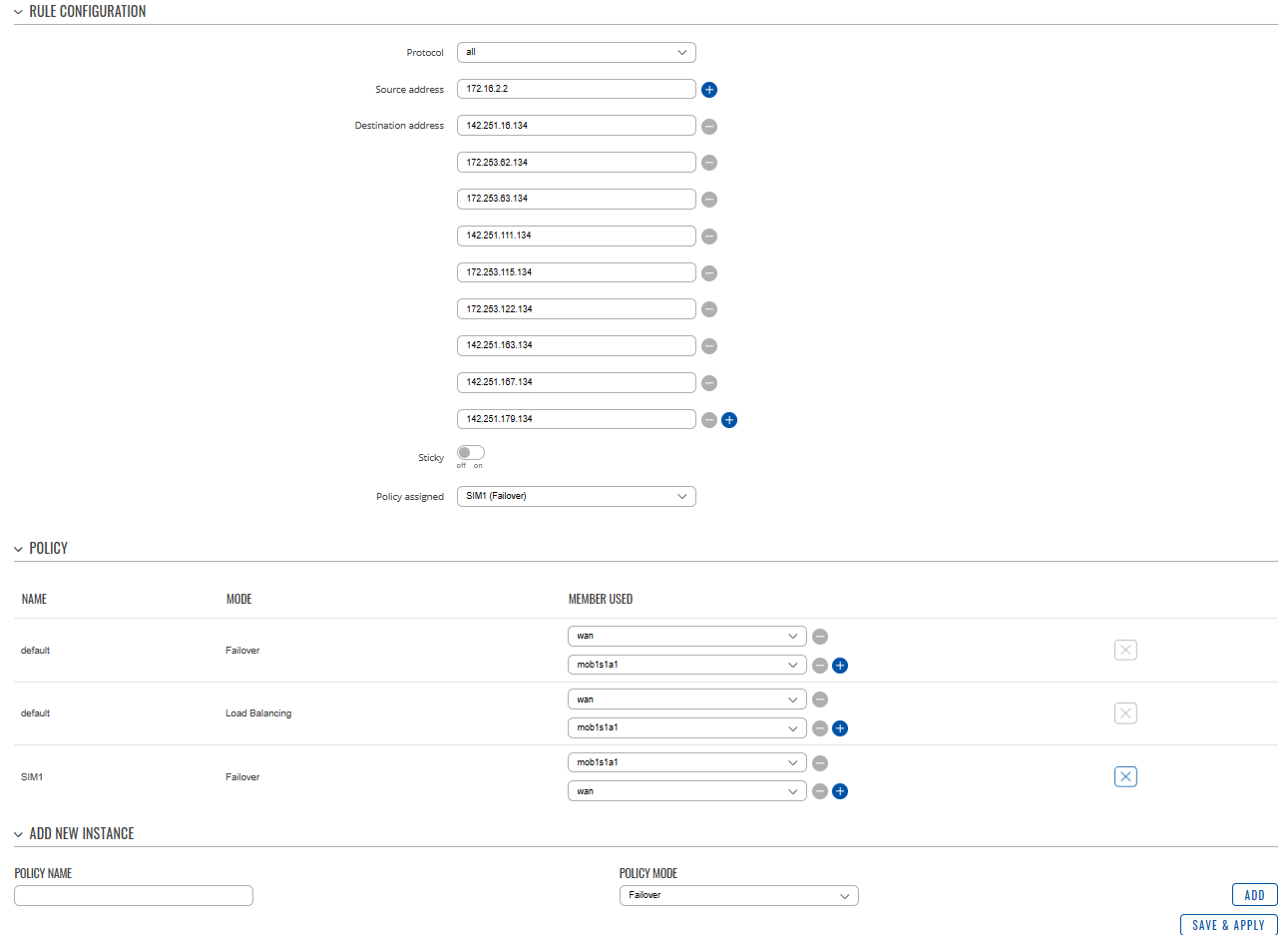

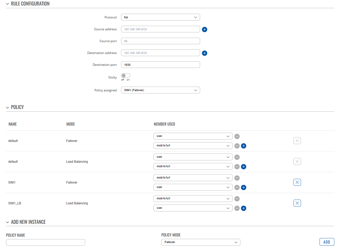

I thought I should be able to set a Failover rule to redirect the traffic via a different policy. I have tried several different ways but it never send it via the 4g network. I tried setting the protocol to TCP and trying to capture traffic on port 1935 but that didn’t work. I also tried setting Protocol to all and setting destination addresses to all the youtube streaming server ip’s but that didn’t work either. I’ve tried it with and without a source address (I used the UDMP external address for this as it’s nat’ing and everything appear to come from there).

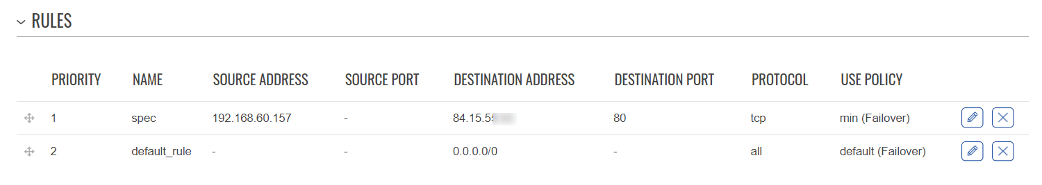

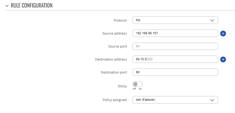

First, make sure you are on the latest firmware version.
The top rule for 172.16.2.2 device will include a policy with the mob1s1a1 interface only, while the default rule for all other traffic (second rule) will included a policy where WAN is MAIN and mob1s1a1 is failover.
Here’s a config example:

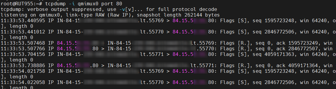

Now, WAN is the MAIN interface in failover, while traffic to 84.15.5x.xxx goes via mobile interface (qmimux is the mobile interface):
