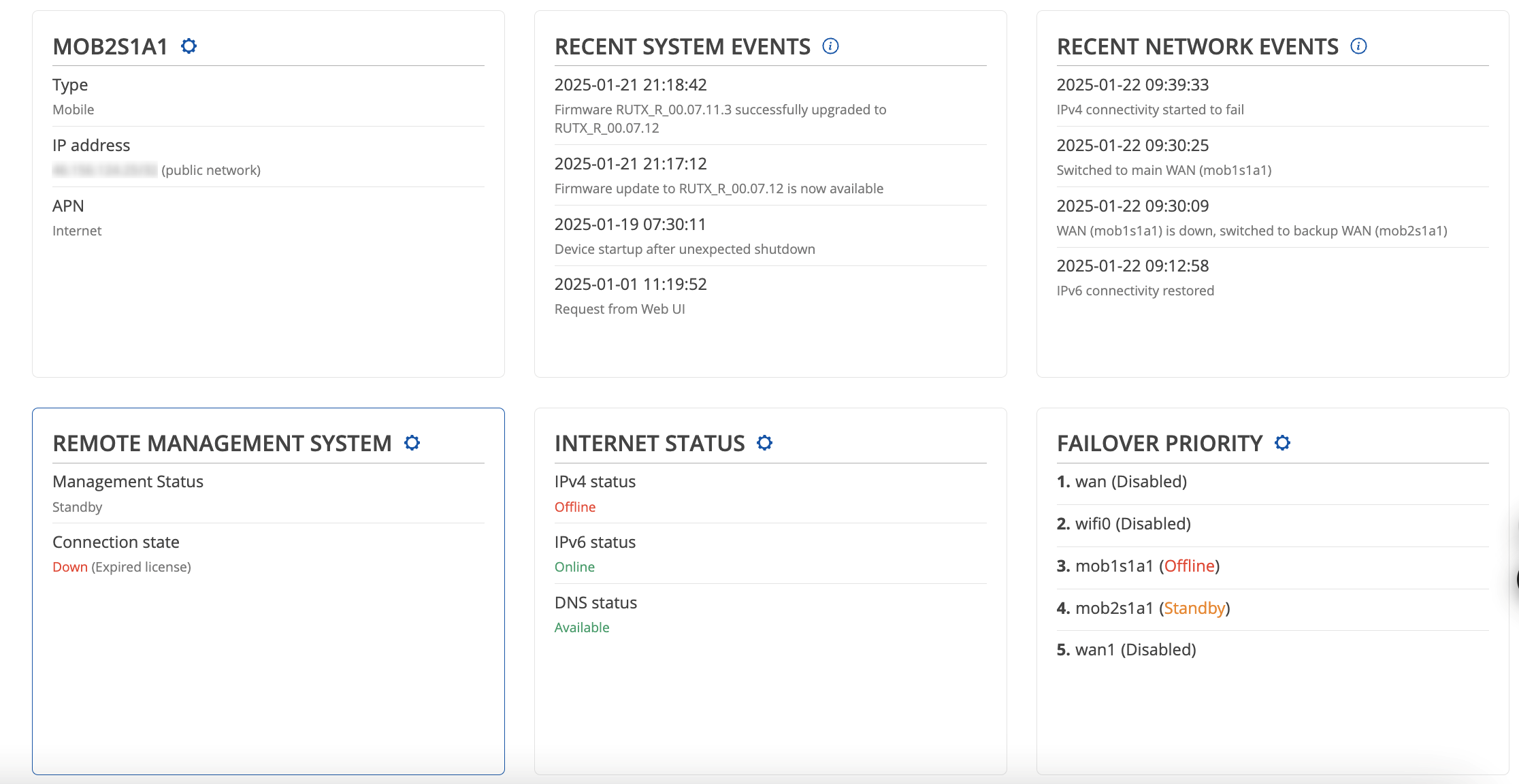

RutX12: Can I get help to diagnose failing Ipv4 connectivity
Have been using this router with SIM card and poynting puck antenna for 1,5 years. The last couple of days it has been malfunctioning and I dont understand why. Where do I start to look? It still works well if I use my phone for internet sharing.
Hope these screenshots might shine some light on something for any of you veterans :slight_smile:

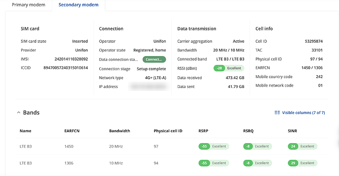

Screenshot
Thank you for the update, and I’m glad to hear the current issue is not present anymore.
Please keep in mind not to share any private or sensitive information in your screenshots (such as public IPs, passwords, or MAC addresses).
If the issue reoccurs in the future, please don’t hesitate to let me know. Additionally, providing relevant information, such as whether the issue happens consistently at the same time each day and logs from System β†’ Maintenance β†’ Event Logs.
And its back! No speedtests done, as I cant open any webpages while connected to the router.
Only images can be uploaded? Event log has a few pages in it…
Event log
