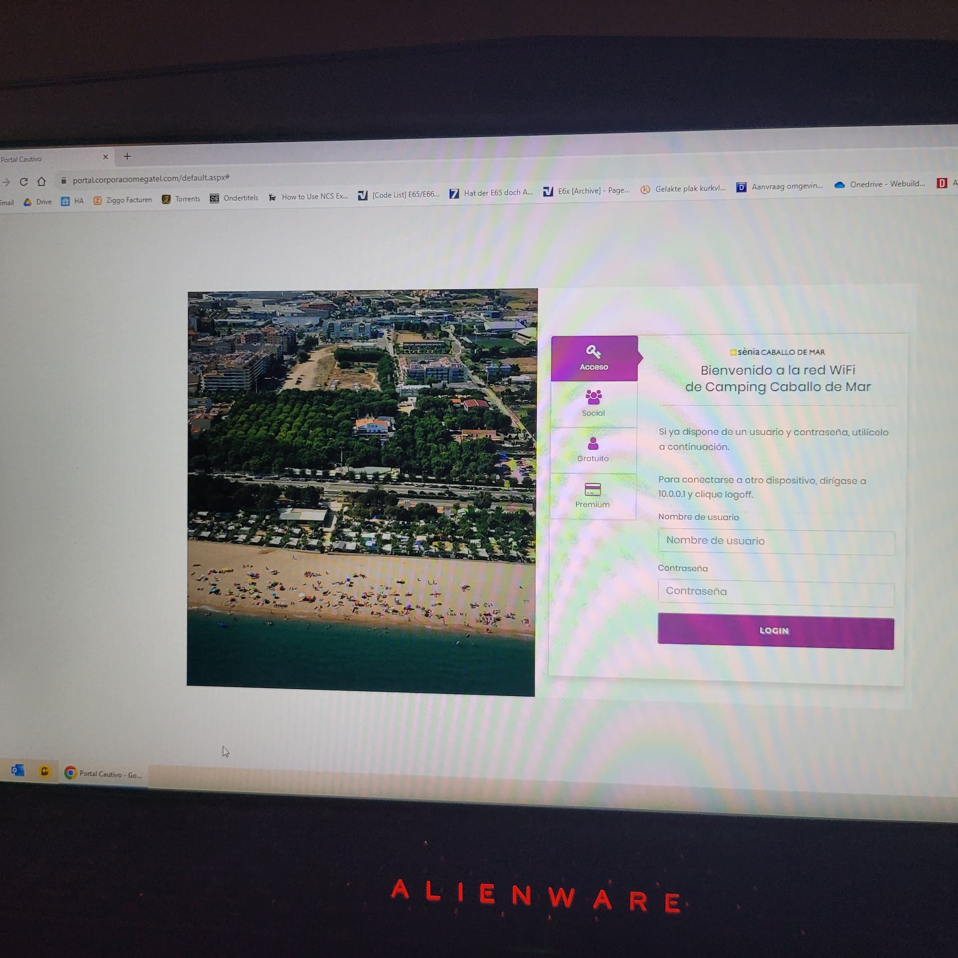

I have a RUTX11 in my rv/camper.
Whenever possible, I use WiFi as WAN at campsites.
But sometimes you have to buy WiFi and then your browser opens immediately after connecting.
No problem on phone and laptop.
But when I join the WiFi network for WiFi as WAN, I don’t get this screen.
And therefore no internet either.

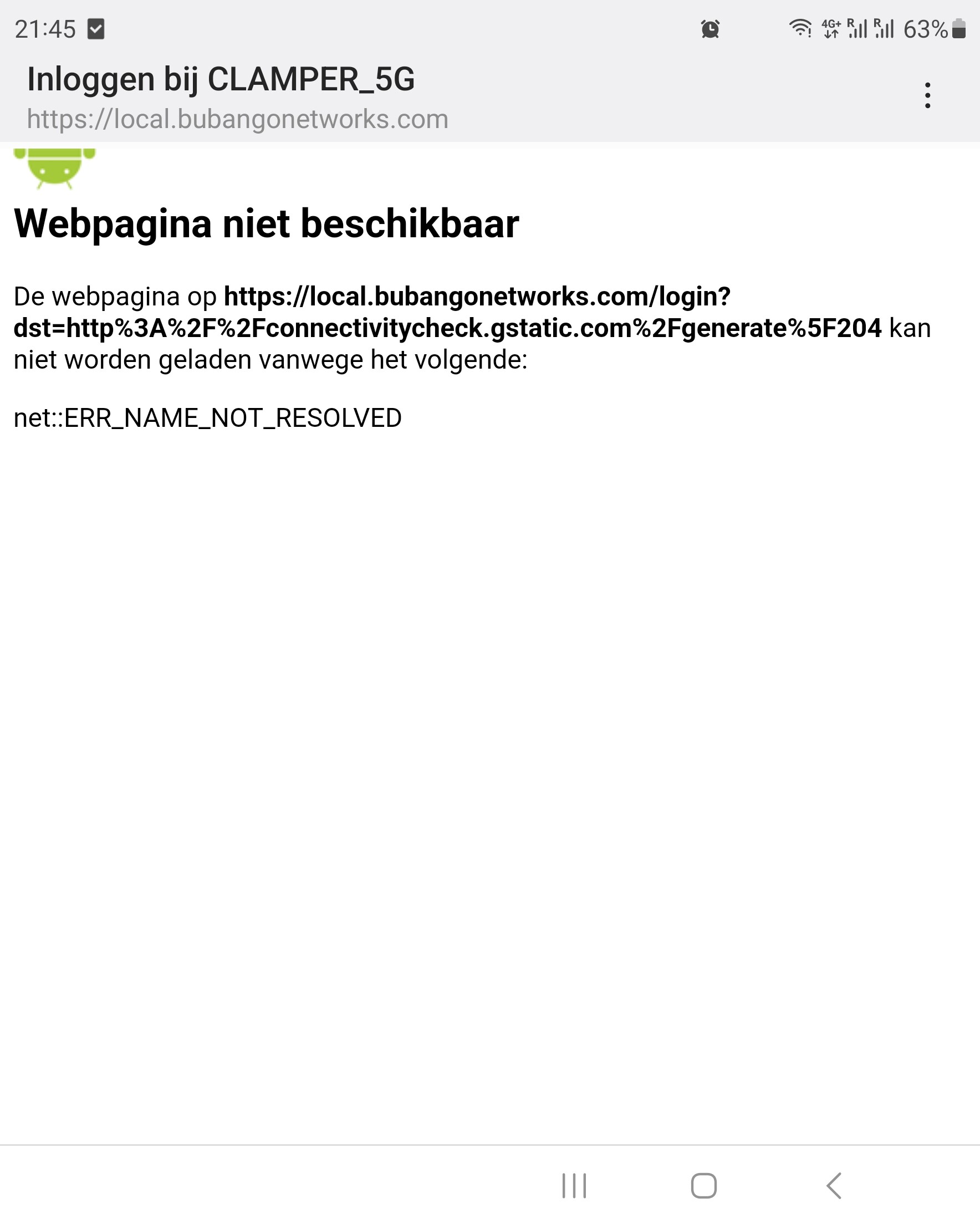

But gets this screen everytime i want to log in (android and wifi windows).
Could you please navigate to Network → DNS and disable rebind protection? Also, try deleting cache in your web browser. Let me know if this helps.
This works!!!
Very happy, thank you for the good help!
