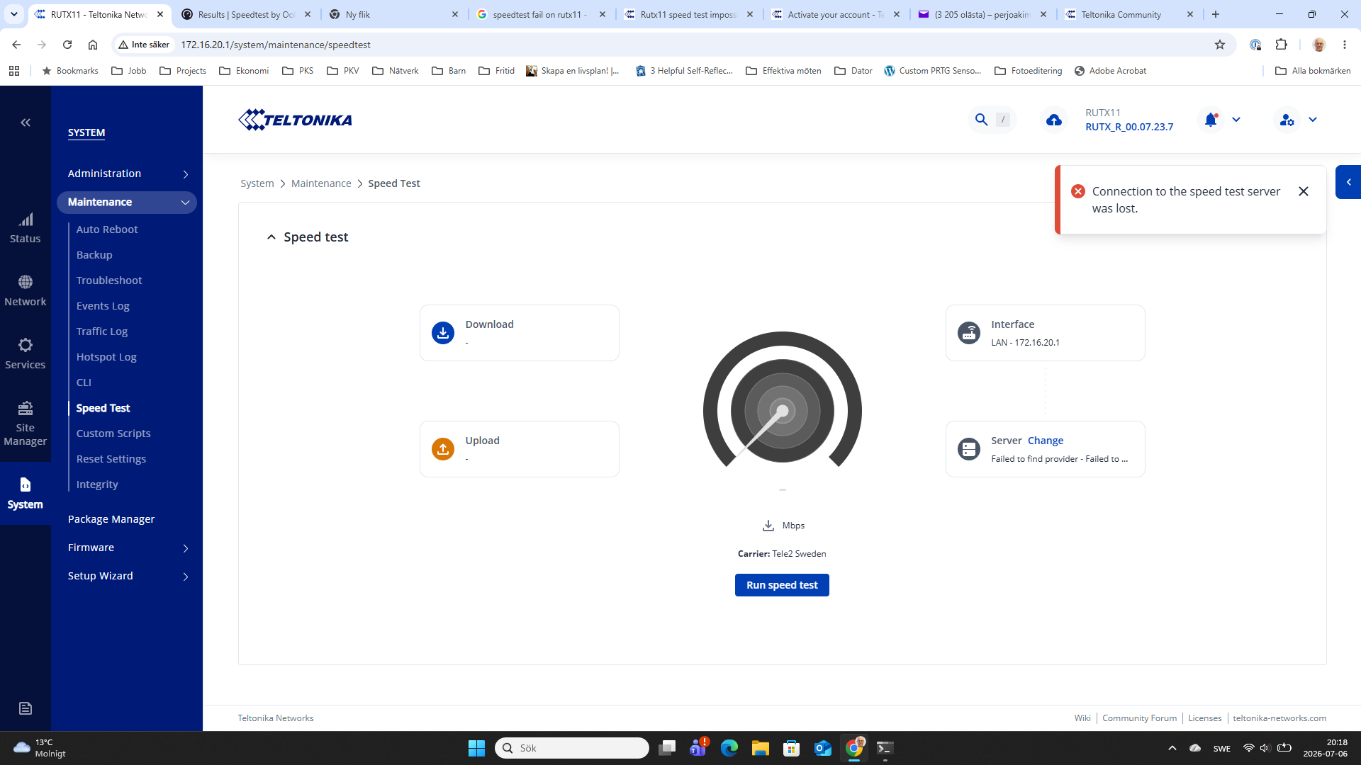

RUTX11 speedtest fails with Connection to the speedtest server was lost
Running RUTX11 with RUTX_R_00.07.23.7 & EG06ELAR04A30M4G.
The unit has a swedish Tele2 SIM but is connected to a mobile network in Finland.
When starting speedtest is the test aborted with the message Connection to the speedtest server was lost.
A computer connected via wifi to rutx11 can run speed tests from speedtest.net.

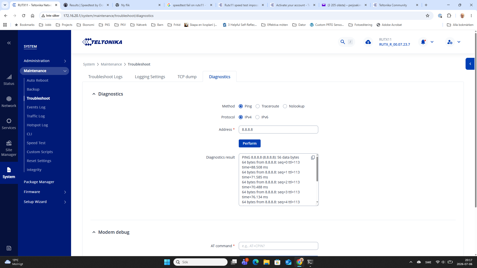

The internet connection is working. Tested to ping 8.8.8.8 from the webui.

Hi, the test fails regardless of which server I pick in the Speed test server list. I only tested with servers in Sweden.
The Server part in the web ui has this error message: Failed to find provider - Failed to find IP
Hello, @jocke2test,
I have an update from our R&D team.
First of all, thank you for reporting this issue. Your feedback helps us improve our products.
The R&D team has confirmed that this issue is planned to be resolved in the upcoming RutOS 00.07.25 firmware release. At this time, however, I do not have an estimated release date (ETA), so I recommend keeping an eye on the latest firmware releases for updates.
Thank you for your cooperation, patience, and understanding.
To confirm, the SpeedTest feature not working is a known firmware issue?
