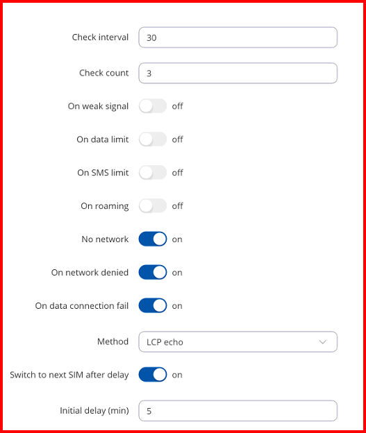

Good morning, when enabling the SIM Switch feature in an RUTX11 with the settings shown below, I observed that the SIMs are being switched every few minutes despite no connectivity issues present. Is this not configured correctly?
Hello, you have enabled Switch to next SIM after delay, so after 5 minutes it will switch to next SIM. Turn off this condition and your switch will be executed only when No network or On network denied or On data connection fail.
Thank you! I misunderstood the Switch to next SIM after delay feature
