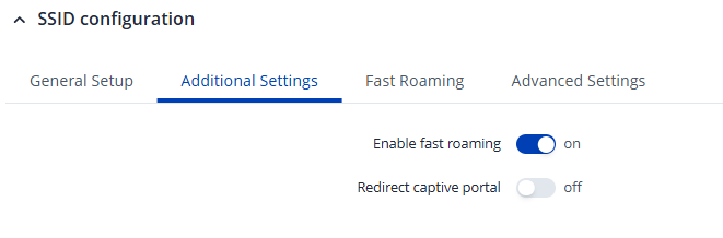

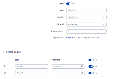

Could you please confirm whether your current Cisco and RUTX11 configuration is operating as part of a mesh network? If so, there is an option within the RUTX11 settings (under mesh configuration, Additional settings tab) to forward mesh peer traffic through another node once the signal between the gateway and the current node falls below a defined threshold.
If, however, you’re using a multi access (multi AP) point environment, where the RUTX11 acts as a wireless client connecting to different Cisco APs, you can enable the Fast Roaming feature that is available under the client SSID’s Advanced Settings tab:
Enabling Fast Roaming allows the router to scan periodically and switch to a stronger AP once the signal strength from the current AP drops below a specified threshold.
