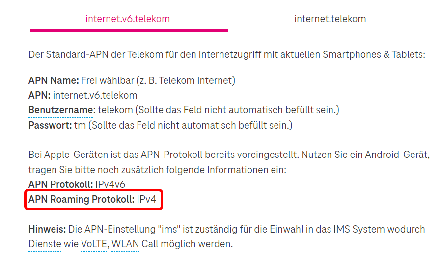

I’ve been using the Rutx11 device for 1 year. I am currently on the road again, this time in Holland. In Holland, too, I have the problem that my device does not connect. I also had the same problems in Sweden where I was in June 2023, there was also a post.
The device has the latest firmware on it, the APN setting is on Maunell (internet.v6.telekom), the SIM card is a Deutsche Telekom Data Card. In Germany, the device connects immediately, only abroad.

  • Additionally, IPv6 might be causing the issues abroad. I’d suggest changing the APN to internet.telekom, and checking if you’re still having issues. Keep in mind, that both internet.telekom and internet.v6.telekom require authentication. Make sure you’ve set telekom as the username, and tm as password;
  • Make sure the PDP type in mob1s1a1 (SIM1) or mob1s2a1 (SIM2) is set to either IPv4/IPv6, or IPv4, as when roaming, IPv6 does not seem to be supported for wither APNs:

Thank you for the logs. It seems like the device is not able to obtain an IP address from the operator, thus after trying a few times, it restarts the modem and tires again. When the issue replicates, I will ask you to log into the WebUI, and run the following command:
gsmctl -A 'AT+CEER'
And post the output in the next comment. This will hopefully provide the reason from the operator for the rejection.
hey, where can I enter this command? I cannot find this area in the web interface.
I have entered the command in the CLI but I get no response.
Apologies, I meant CLI or SSH: Command Line Interfaces RutOS - Teltonika Networks Wiki
Is the response OK, or are you getting no response at all?
I entered the command when I received feedback
+CEER: 6,259
I entered the command 2 times in a row and this happened on 2 attempts
[handle_requests:317] error: Failed to handle AT exec. ERR: Not found
I just noticed, that the device is connecting to Odido operator. Just to understand the situation better, you are currently physically located in the Netherlands, and using Deutsche Telekom SIM card, is that correct? Perhaps you could try blacklisting this operator by navigating to Network → Mobile → Network Operators?
If so, please try navigating to Network → Interfaces → General, edit the mob1s1a1 interface, and change the PDP type to IPv4.
