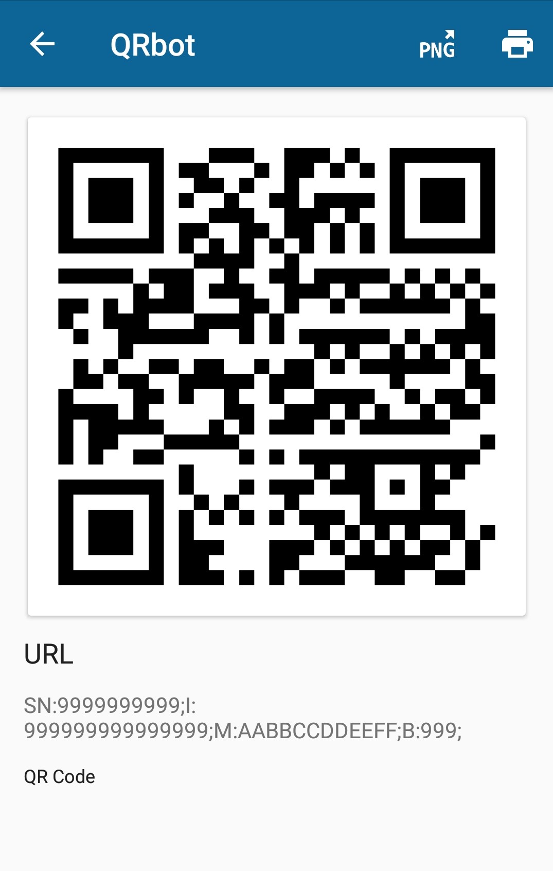

I have a picture from the Label on the Router, but there is no product code on it.
Where can i see the gsm.log?
