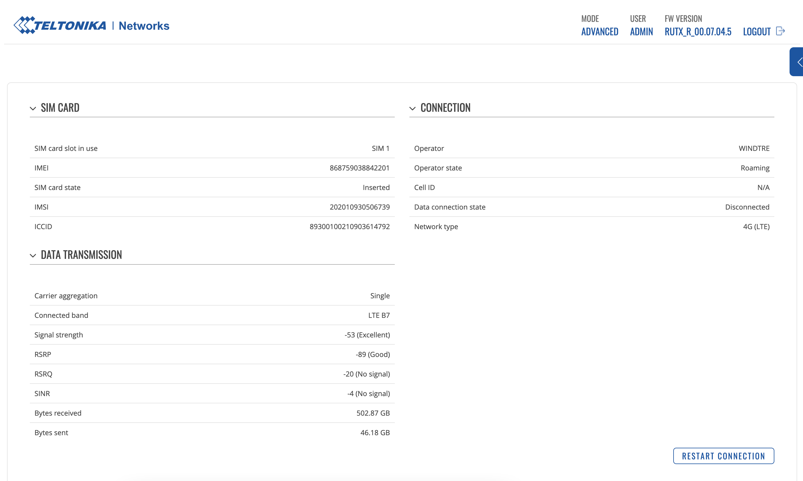

I’m having problems with keeping a stable 4G connection. It says Disconnected from time to time, no specific pattern.

Thank you for providing the logs and screenshots!
Since this is only one instance of disconnection, it’s hard to say if this is exactly the cause, but certain signal parameters are really bad and could cause a disconnection. It is very unusual for the RSSI and RSRP to be this good, while the SINR and and RSRQ is this bad. Perhaps you could provide the following information:
  • How and where is the antenna mounted?
  • What antenna is being used?
  • Are both mobile antenna connectors connected and tightened properly?
Both SINR (signal-to-noise ratio) and RSRQ (reference signal received quality) are parameters used to measure signal quality, and not strength, thus I’d also suggest checking if there are no other RF pollutants nearby.
Additionally, if you manage to catch this event again, could you provide the logs from a little bit earlier? The logs you attached only contains the router attempts to reconnect, but does not contain the event when the connection was lost.
Thank you!
Hello Daumantas,
  • The antenna is mounted in top of a mast on a sailing yacht
  • I use the QuSpot antenna where the router is inside
  • Yes, both are tightened properly
Here is a fresh log after it disconnected again:
