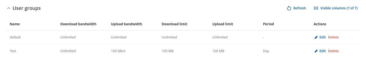

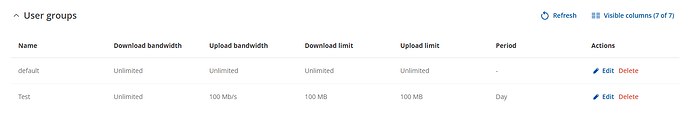

Simply create a new user group:

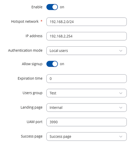

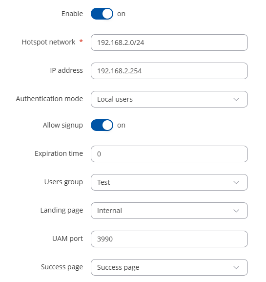

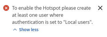

Then assign it in the general hotspot settings as seen here:

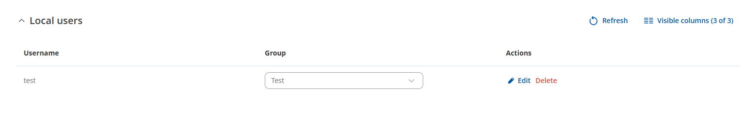

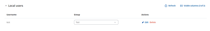

And also create a local user (you only need one):

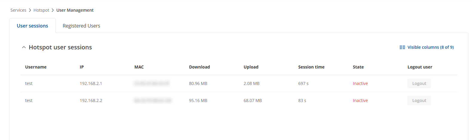

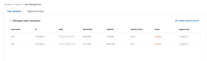

You can then enable the Hotspot and whenever users login, they will have to write the password and username that you’ve set. Each user will be separated and they will have separate data limits (say you set 1000MB per day for each user):
