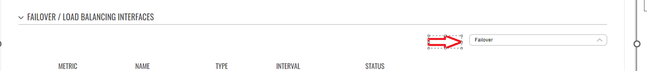

**Navigate to Networks → Failover → Select Failover Opti

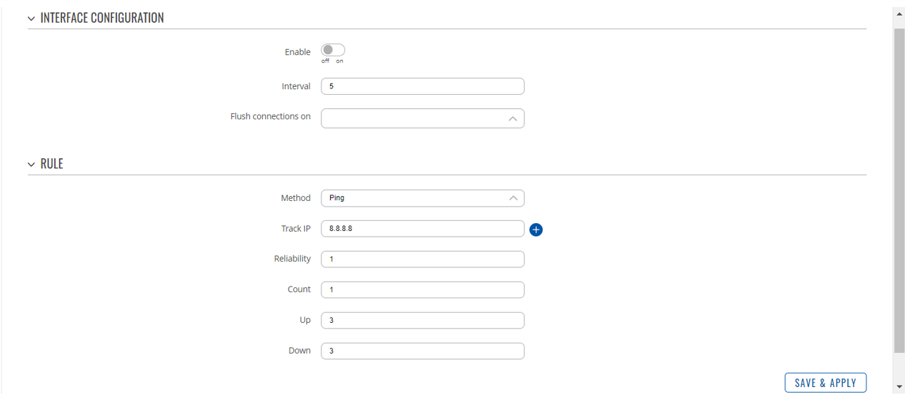

Click & Edit for failover Interface Configuration & Enable the instance.

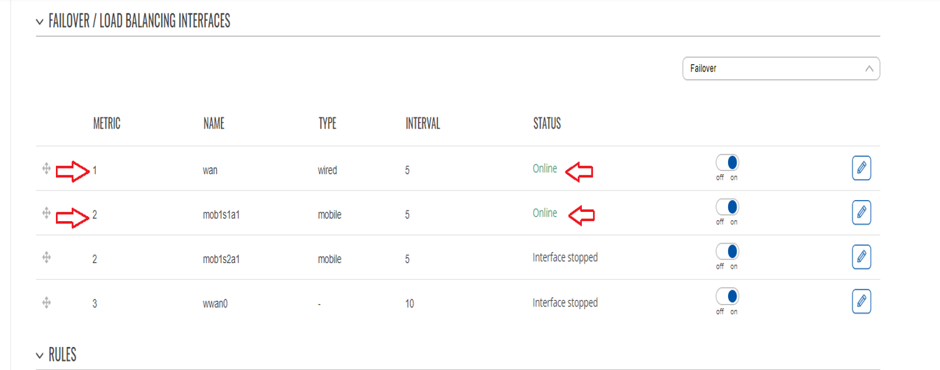

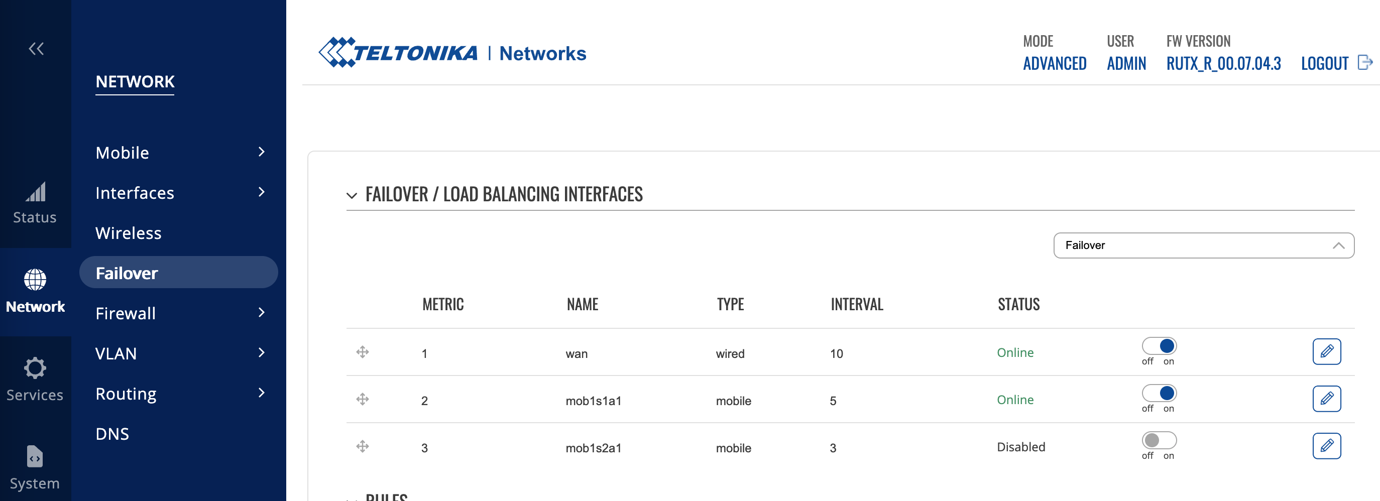

  • Since I’ve chosen to use Wired WAN as a secondary WAN and SIM 1 mobile WAN as my primary WAN
  • To set priorities, all you need to do is use the left mouse button to click on the interface, drag an item to the first, second, or other place, and then click Save & Apply.
  • Both WANs are operational in my situation because both are online.
  • As soon as SIM 1’s mobile connectivity fails, the device will automatically switch to the interface with the next greatest priority, which in my instance is Wired WAN.
