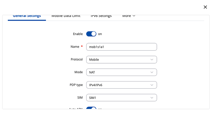

  5. Check PDP type:
    Navigate to Network → WAN → <mobile_interface> → Edit in the WebUI. Under mobile interface settings, there are three PDP types:
    • IPv4
    • IPv4/IPv6
    • IPv6
    Make sure the correct PDP type is selected according to your cellular provider’s network (they may assign IPv4, IPv6, or both types of IP addresses).
Antennas are connected properly, SIM card works OK no problems on cellphone.
The issue started when we applied the latest firmware update now the device does not connect to any SIM CARD. settings are default.
