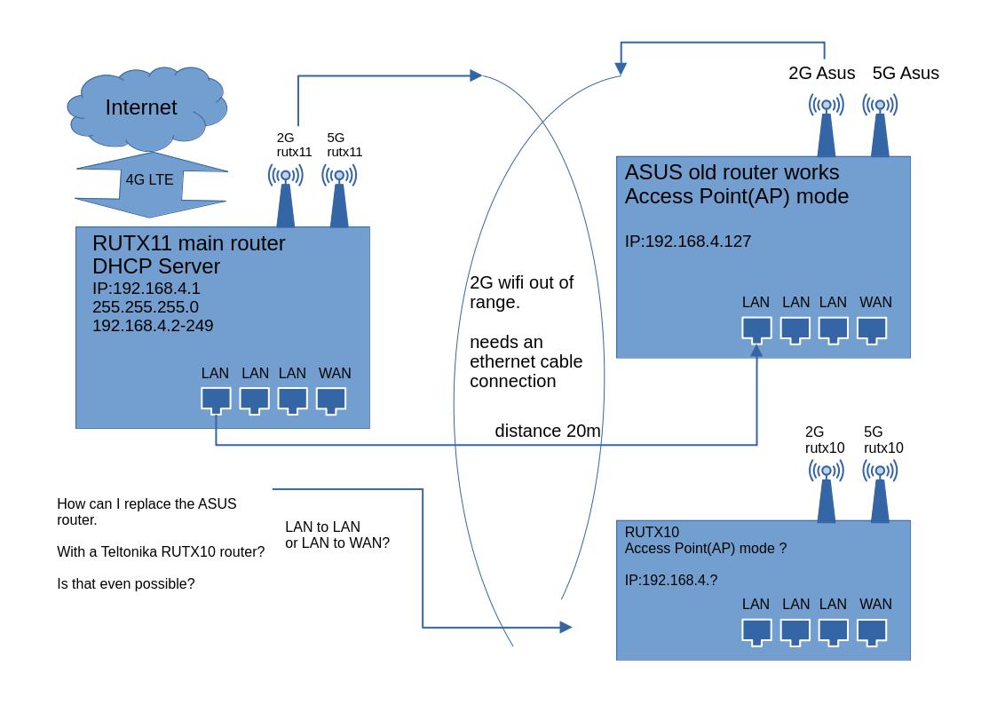

You mention that RUTX10 refuses to connect. Are there any errors? How are you trying to connect the devices? If both RUTX10 and RUTX11 are used in the same topology, could you please share a diagram?

I have tried to connect RUTX11 and RUTX10 with instructions

Assuming that RUTX10 is on the same network as RUTX11, simply set a static IP address on RUTX10 LAN to something like 192.168.4.2. Connect RUTX10 and RUTX11 from LAN to LAN. Then, disable DHCP server on RUTX10. Since the devices are going to be on the same network, the LAN clients (including RUTX10 wifi clients) should be able to get an IP address from RUTX11. Once they get DHCP lease from the RUTX11, they will know that they can reach internet via RUTX11 (default gateway 192.168.4.1).
So I had assumed that Teltonika routers cannot be connected LAN - LAN. Because I couldn’t find instructions for it.
By chance I had already managed to get a connection, but the speed setting of the ethernet cable caused interference.
In the meantime, I’ll replace the new cable CAT6a FTP.
