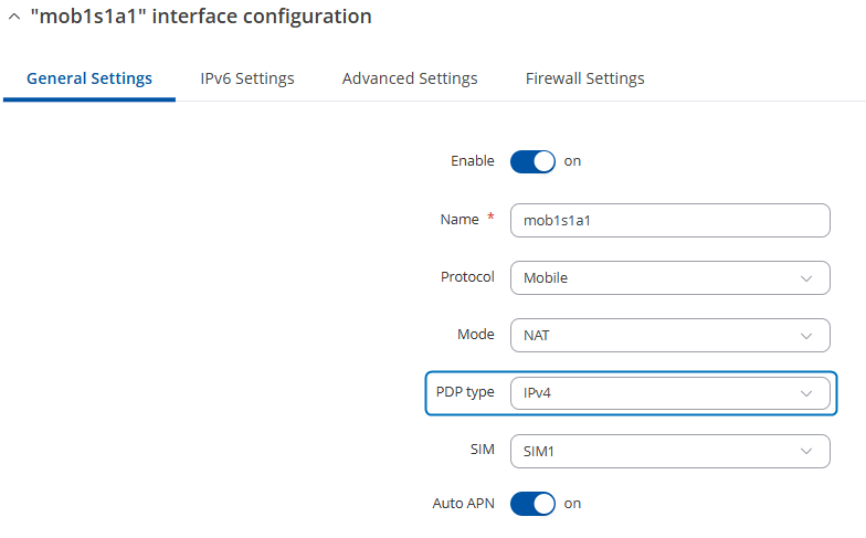

Could you please check what IP type (IPv4 or IPv6) you’re receiving from your ISP on the mobile WAN interface (mob1s1a1)? If it’s IPv6, please try changing the PDP type to IPv4 by navigating to the Network → WAN page and pressing Edit on the mob1s1a1 interface.
PDP IPv4 option
Additionally, I’d recommend enabling all available Flush connections on options for both the WAN and mob1s1a1 failover interfaces.
Could you please give this a try and let me know if it resolves the issue?
