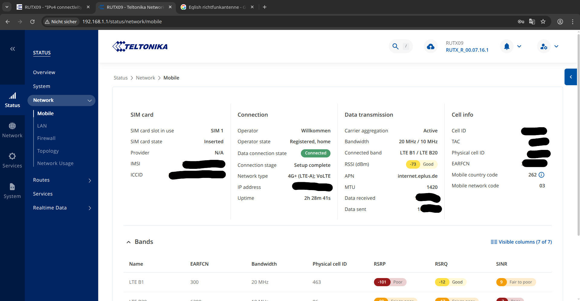

  3. Please provide a screenshot of the Status → Network → Mobile page, ensuring any sensitive information (public IP addresses, ICCID, IMEI, etc.) is hidden or blurred.

  • Attached I put 2 screenshots of the “Status → Network → Mobile page” showing the “instable behavior”.
