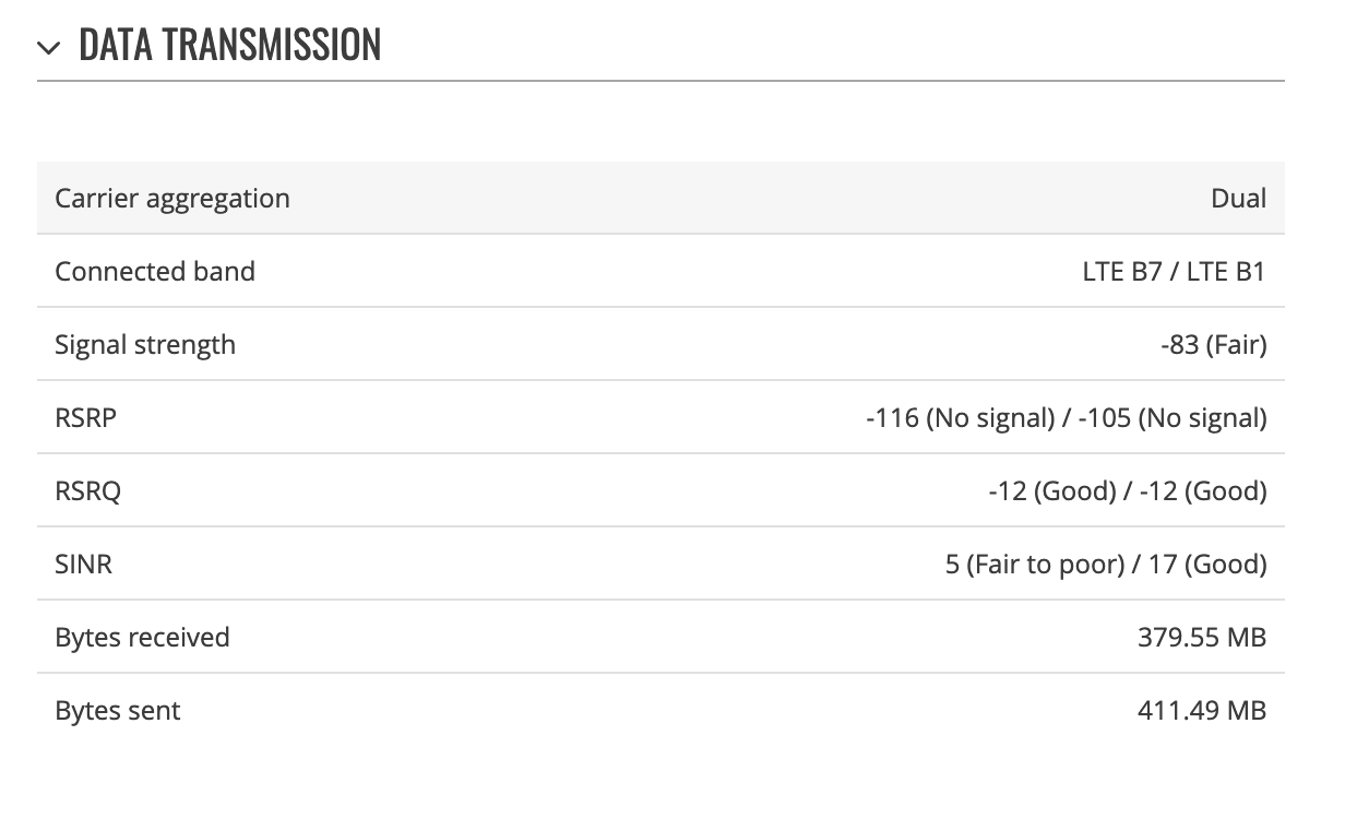

This problem is intermittent and not always present. At the moment this is the information in the Data transmission tab:
Carrier aggregation Dual
Connected band LTE B7 / LTE B1
Signal strength -86 (Poor)
RSRP -116 (No signal) / -106 (No signal)
RSRQ -12 (Good) / -11 (Good)
SINR 6 (Fair to poor) / 13 (Fair to poor)
Bytes received 379.61 MB
Bytes sent 411.59 MB

From the screenshot it seems that the RSRP is really bad. You can refer to the recommended signal parameters here.
You mention that the device connects for some time if you restart the mobile connection. Can you take a note of the frequency bands that are used right after a restart? Try setting those bands manually in Network → Mobile → General.
