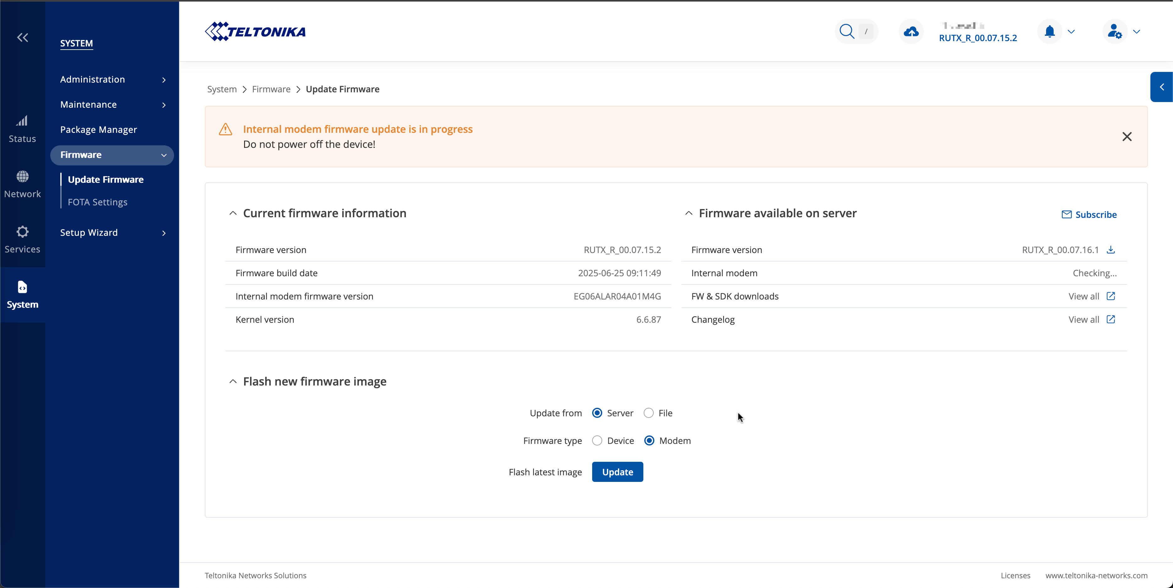

Heads up! Today I was doing some routine maintenance for a customer site on their RUTX11 (7.15.2 firmware), when a banner appeared at the top of the GUI saying “important update for modem firmware available”
“What the hell” I thought, “they’re using the hardwired WAN connection anyway”. So off I went, after about 5 minutes, I got some alerts from my monitoring software that the site was offline. Sure enough, I could no longer access the device, and soon after the office called me to say that the “internet was not working”
I told them to wait (was worried about resetting the device in the middle of what I assumed was a flash operation). But, after 25 more minutes went by, I had no choice—I instructed them to unplug and re-plug.
Thankfully the device booted back up, and appears to be working normally. The modem firmware seems to have updated as well.
Here’s a screenshot I was able to capture before the device went belly up:
Any idea what happened here?

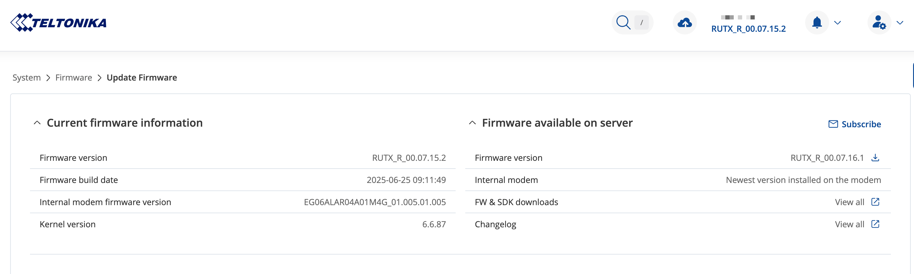

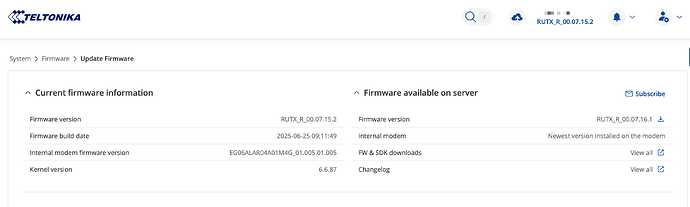

I see that your device has updated the modem firmware from EG06ALAR04A01M4G. Could you please let me know which firmware version it was updated to?
Thank you.
Yes, the device updated to version EG06ALAR04A01M4G_01.005.01.005
