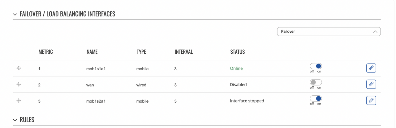

Here are the settings I have for the failover (wan is disabled in case it was interfering but if I turn it on then it works if I remove the SIM from Slot 1)

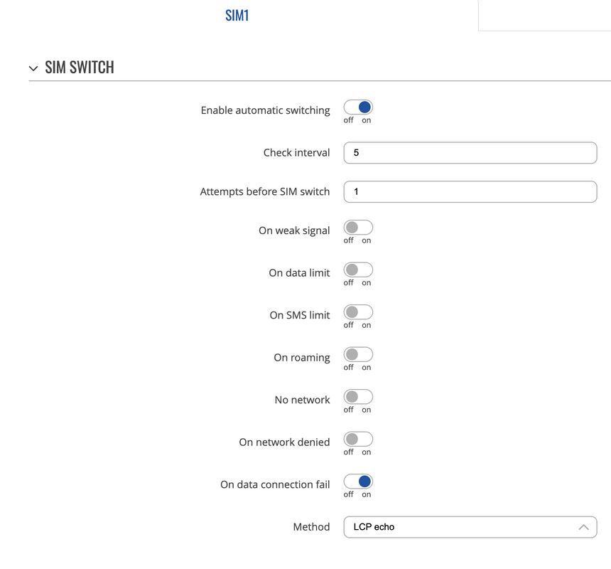

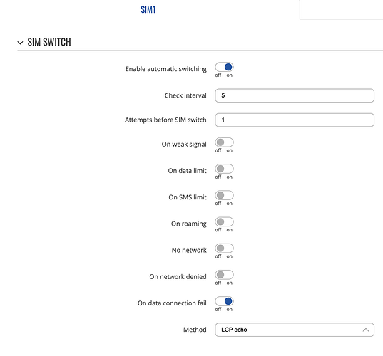

I also set up SIM switching with the default settings and added the “no network” and “on data connection fail” parameters.

Since RUTX50 only contains one LTE/5G modem, Failover feature can only be used between wired WAN and the mobile connection, so since you also have a wired connection present, all 3 interfaces should be enabled.
SIM Switch seems to be configured correctly - after 3 failed checks with 30 second interval (3 x 30 = 90s) the router will switch to the second SIM, perhaps you did not wait long enough? Additionally, make sure to specify a rule when the RUTX50 should switch back to the primary SIM in the SIM2 tab.
Finally, make sure that the latest firmware version is used, as the previous versions contained issues with SIM Switch on RUTX50.

The wired lan was just an experiment but it is no longer connected. I disabled the rule to make sure it wasn’t interfering with SIM to SIM failover.

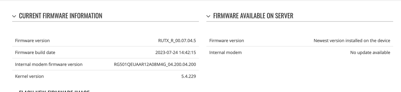

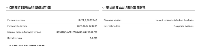

I realised that I’d updated the firmware on the router when I first installed it, but I had not done so for the modem.
I updated that before today’s tests.

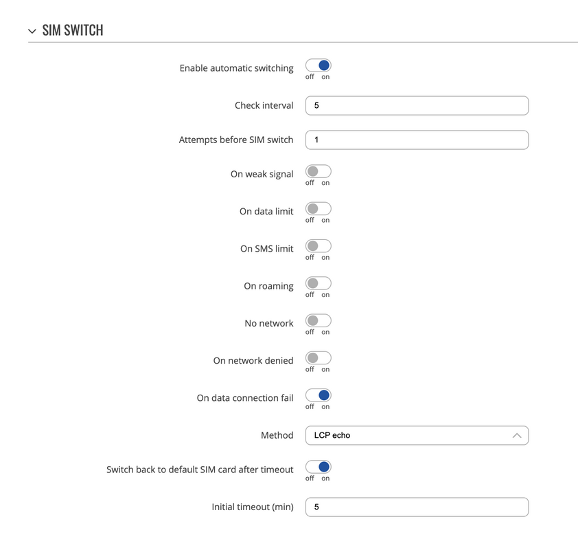

To prevent waiting too long I set the delay to 5 seconds and 1 attempt on both SIM1 and SIM2

On my first test I removed the card and it took 35 seconds for the 3/4/5G lights to start blinking on the front of the unit.
I waited 4 minutes from the removal of the SIM with no change and then re-inserted the SIM.
Two minutes later there was still no change so I rebooted the router from the web interface.
I really think this is bad. The router should be able to find the SIM again after it has been re-inserted without needing a reboot.

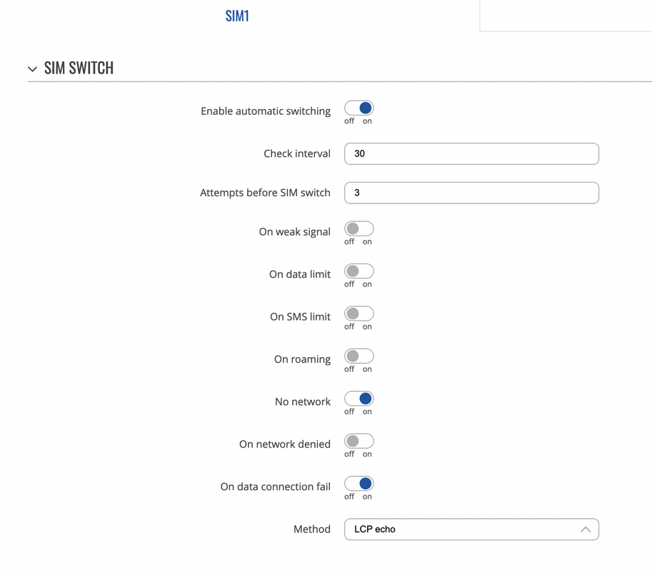

For test 2 I decided to put the timeout intervals back to 30 seconds with 3 tries to see if that made any difference.
It took 15 seconds after I removed the SIM for the SIM1 light to go out on the front of the unit and 24 seconds before the 3/4/5G lights to start blinking.
Failover to SIM2 eventually worked, but it was 3 minutes and 20 seconds from initial removal of the SIM.

Firmware details:
