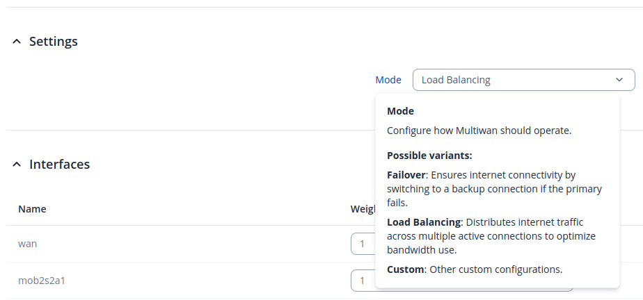

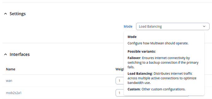

However, in the Multi-WAN general settings I can only select Failover or Load Balancing as the global mode. The documentation states that only one of them can be activated the same time, so I’m not sure if I can archive this behavior. But the help text mentions a Custom mode but I don’t see a way to activate it, I attached a picture of this option below.
