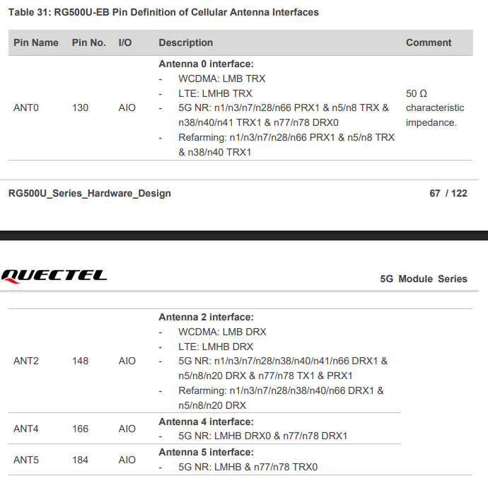

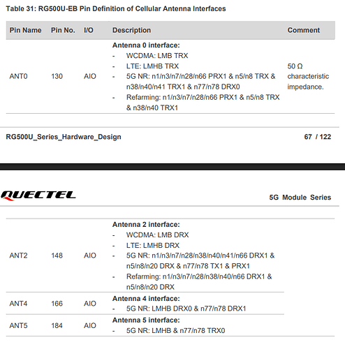

As far as I know RUTM51 uses RG500U-EB modem.
Yes, all antennas are main, but different antenna ports can operate on different frequencies
Here is the hardware document from Quectel page:

Seems that ANT0+2 is a pair, and ANT4+5 is a pair where 4+5 is dedicated 5G/3MHz, while 0+2 covers both low&high frequencies and combine 4G and 5G. Or… :slight_smile: ??
