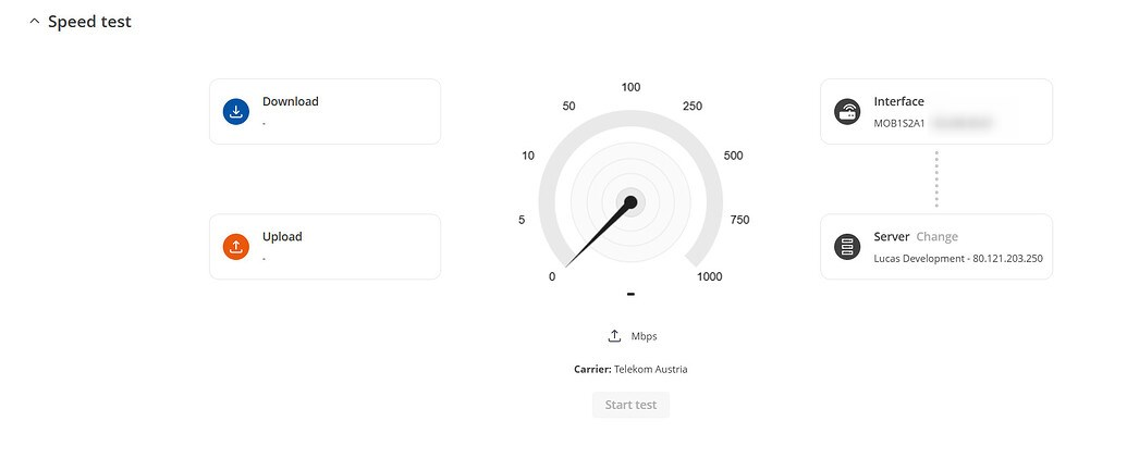

Furthermore, the internal speed test no longer works. As soon as you try to start it or change the server, the corresponding field turns grey and nothing happens.

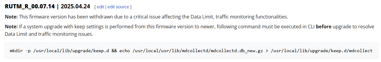

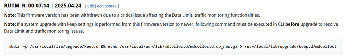

Firstly, just to confirm, was the update from 7.14 to 7.14.2 performed following the instructions found on the firmware downloads wiki page:
From your description, this does sound quite similar to a case we’ve seen reported here:

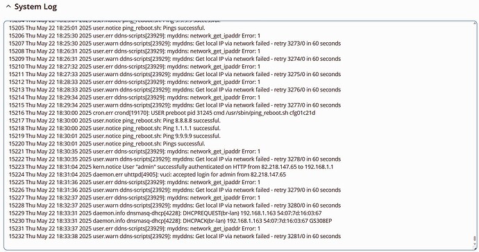

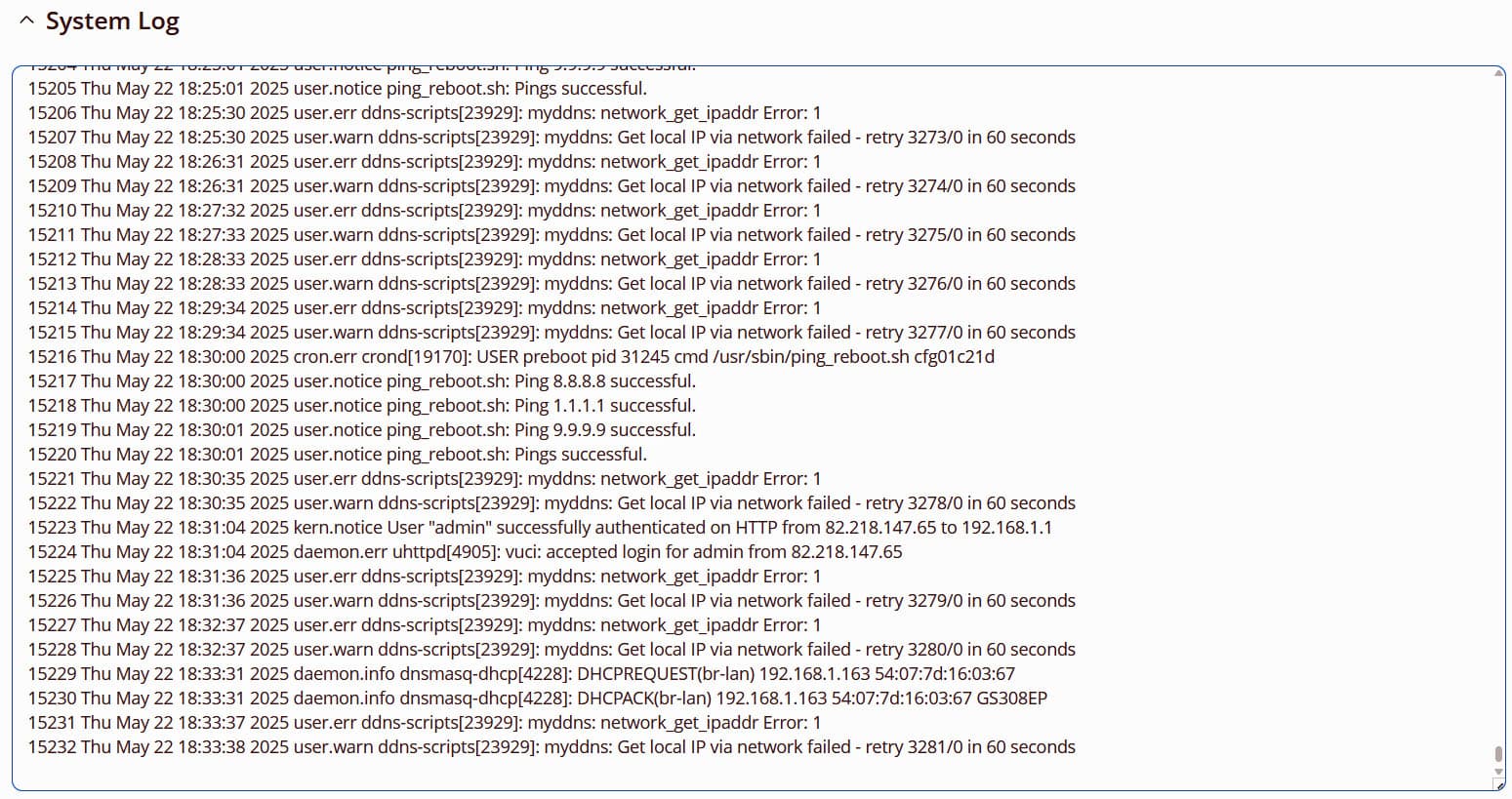

I added the log immediately after running the speed test.
I started the speed test at exactly 1833 and after 30 seconds it still looked like this:
Then i showed the log, and it appears like this:
