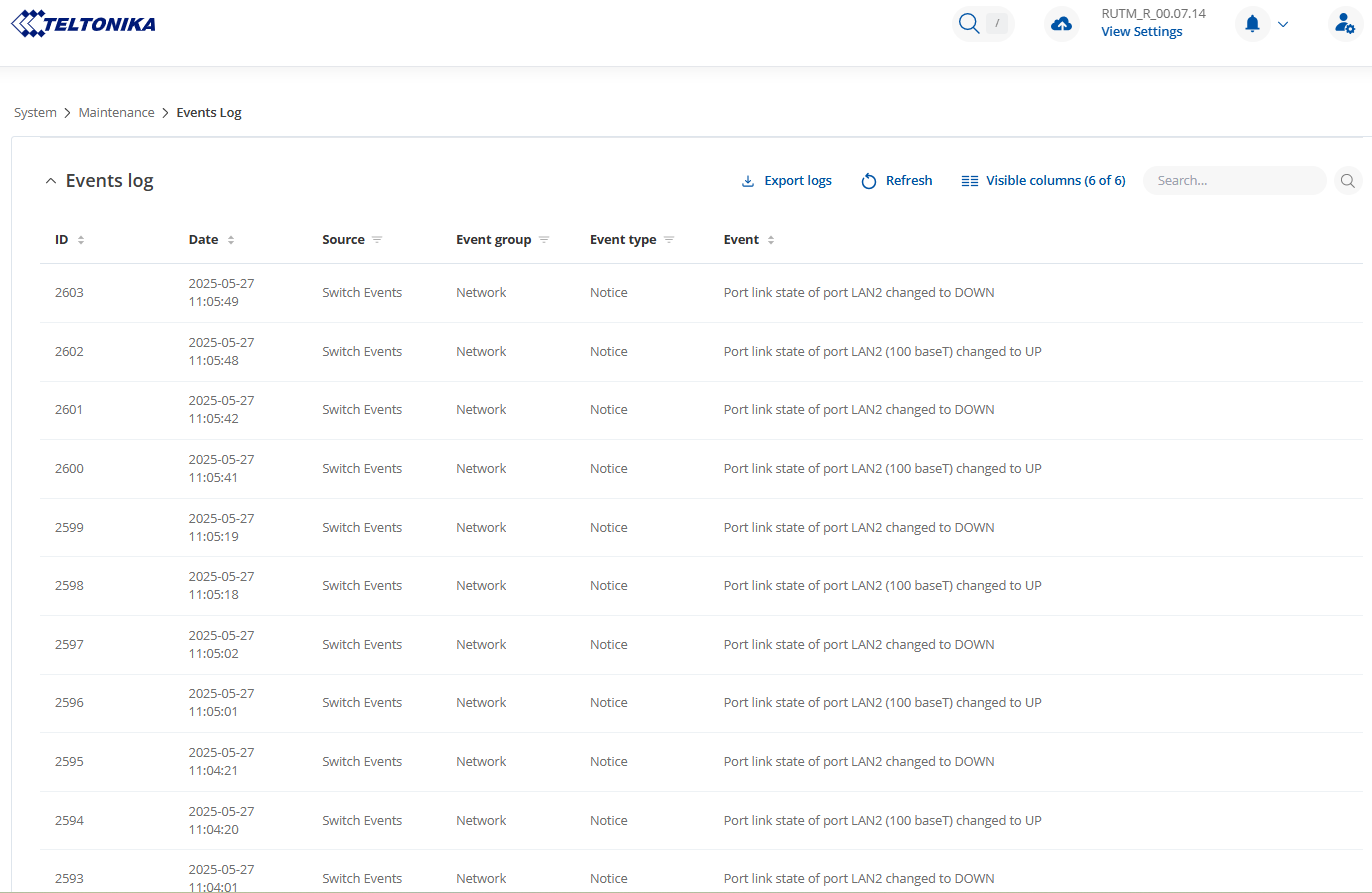

What we do notice, when looking at the maintenance log of the router, is a whole series of interchanging UP and DOWN switch events on the LAN port that the camera is connected to. See screenshot below:
This goes on forever until we do the power disconnection / reconnection action to the camera.

The repeated UP/DOWN events on the LAN port indicate possible cable or port issues. Try replacing the Ethernet cable connecting the camera to the router and test with a different LAN port on the RUTM51. Faulty cables or ports can cause link flapping and loss of connectivity

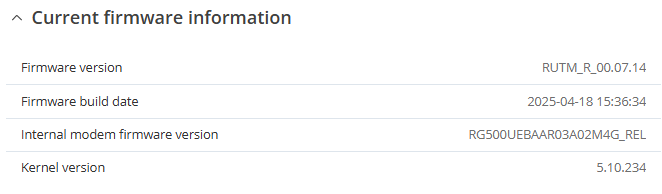

Upgrade the device’s firmware to the newest also.

we have replaced the cables between the router and the camera and that has indeed solved the issues. We suspect now that the UTP cable was the cause of the issues (we separated data from power by using 2 separate cables, then still experienced issues, but when we then replaced the data cable, all issues were solved.
