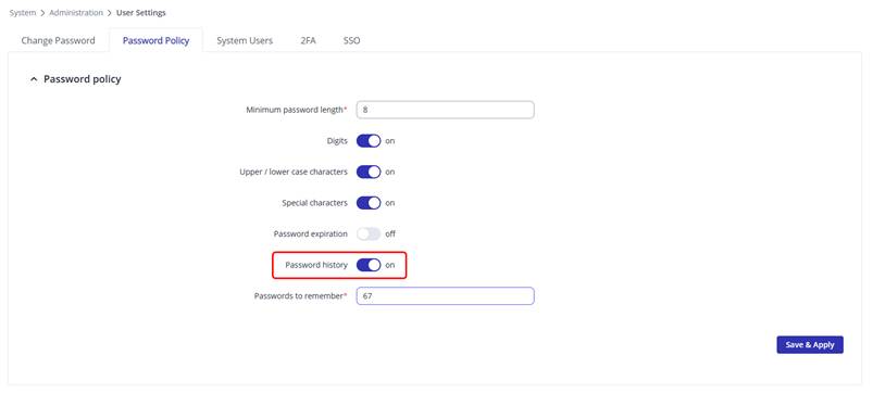

As a workaround, please enable Password History under System → Administration → User Settings → Password Policy, save the changes, and then try changing the administrator password again. Once the password has been changed successfully, Password History can be disabled again if required.
