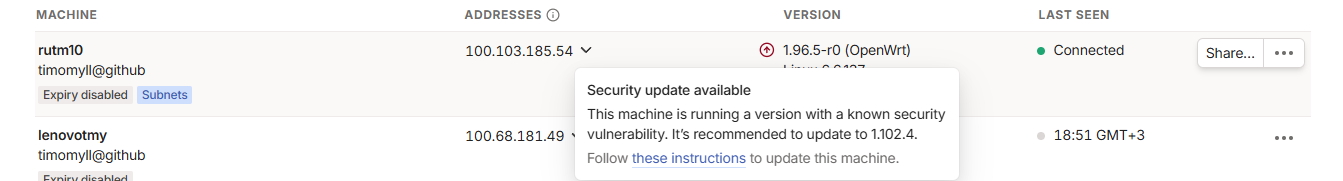

The Tailscale security update was released after firmware version 07.25 was already released. At the moment, there is no supported method to manually update the Tailscale version on our devices. Updated Tailscale versions need to be tested beforehand to ensure compatibility and proper functionality with our devices.
Our R&D team is aware of this issue, and it is planned to be addressed in firmware version 07.26.
At the time of writing, we do not have an exact release date for this firmware version. However, we recommend keeping an eye on the Changelog section of the device’s firmware download page for further updates:

​I managed to get Tailscale working via SSH using a 3rd-party certificate, but Tailscale still shows as stopped in the WebUI.
wget --no-check-certificate -O /etc/tailscale/cacert.pem https://curl.se/ca/cacert.pem
export SSL_CERT_FILE=/etc/tailscale/cacert.pem
opkg update && opkg install tailscale
Now I update RUM11 in 00.07.25.3 and install tailscale package and enable it. Use auth key and save. Now tailscale status is connected.
