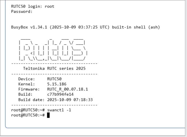

How to check this ? and what is swanctl -l ?
thank you

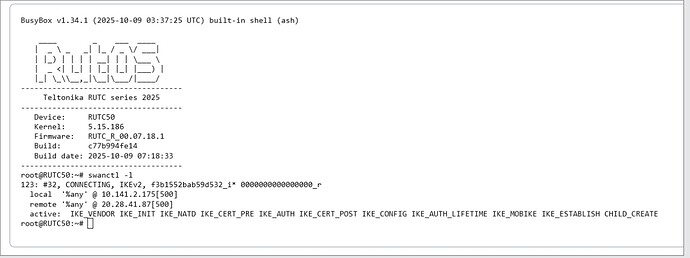

The ipsec command was a legacy tool, while swanctl is the more modern tool. This is why IPsec functionality has been migrated to swanctl.

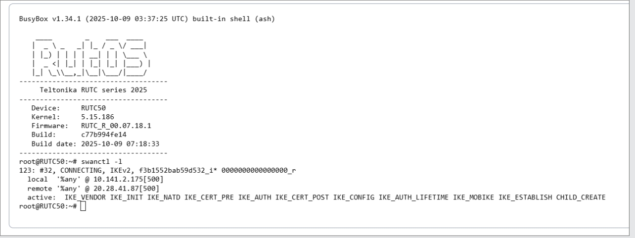

Could you please confirm whether swanctl -l does not show the IPsec status, or if you are experiencing a different issue?
nothing on this command

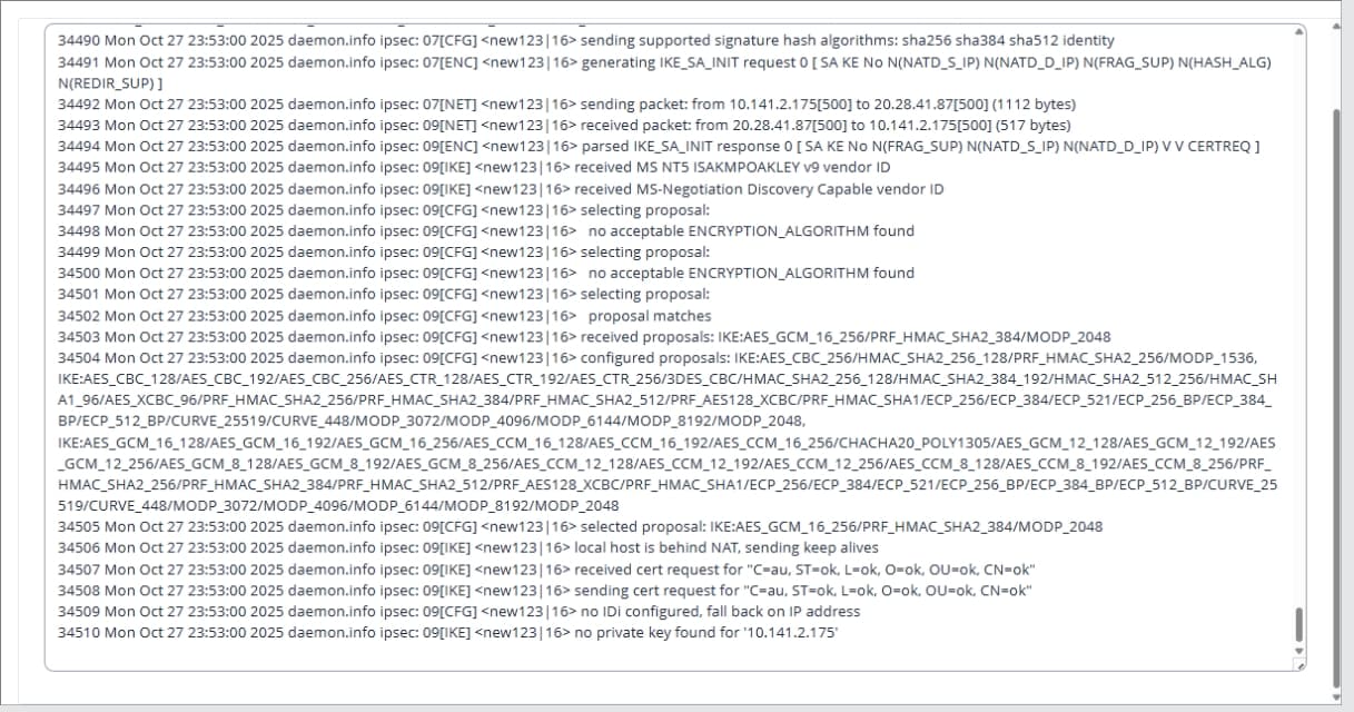

2551 Mon Oct 27 21:09:10 2025 daemon.info ipsec: 15[NET] <123|6> sending packet: from 10.141.2.175[500] to 20.28.41.87[500] (1112 bytes)
2552 Mon Oct 27 21:09:10 2025 daemon.info ipsec: 10[NET] <123|6> received packet: from 20.28.41.87[500] to 10.141.2.175[500] (517 bytes)
2553 Mon Oct 27 21:09:10 2025 daemon.info ipsec: 10[ENC] <123|6> parsed IKE_SA_INIT response 0 [ SA KE No N(FRAG_SUP) N(NATD_S_IP) N(NATD_D_IP) V V CERTREQ ]
2554 Mon Oct 27 21:09:10 2025 daemon.info ipsec: 10[IKE] <123|6> received MS NT5 ISAKMPOAKLEY v9 vendor ID
2555 Mon Oct 27 21:09:10 2025 daemon.info ipsec: 10[IKE] <123|6> received MS-Negotiation Discovery Capable vendor ID
2556 Mon Oct 27 21:09:10 2025 daemon.info ipsec: 10[CFG] <123|6> selecting proposal:
2557 Mon Oct 27 21:09:10 2025 daemon.info ipsec: 10[CFG] <123|6> no acceptable ENCRYPTION_ALGORITHM found
2558 Mon Oct 27 21:09:10 2025 daemon.info ipsec: 10[CFG] <123|6> selecting proposal:
2559 Mon Oct 27 21:09:10 2025 daemon.info ipsec: 10[CFG] <123|6> no acceptable ENCRYPTION_ALGORITHM found
2560 Mon Oct 27 21:09:10 2025 daemon.info ipsec: 10[CFG] <123|6> selecting proposal:
2561 Mon Oct 27 21:09:10 2025 daemon.info ipsec: 10[CFG] <123|6> proposal matches
2562 Mon Oct 27 21:09:10 2025 daemon.info ipsec: 10[CFG] <123|6> received proposals: IKE:AES_GCM_16_256/PRF_HMAC_SHA2_384/MODP_2048
2563 Mon Oct 27 21:09:10 2025 daemon.info ipsec: 10[CFG] <123|6> configured proposals: IKE:AES_CBC_128/HMAC_SHA1_96/PRF_HMAC_SHA1/MODP_1536, IKE:AES_CBC_128/AES_CBC_192/AES_CBC_256/AES_CTR_128/AES_CTR_192/AES_CTR_256/3DES_CBC/HMAC_SHA2_256_128/HMAC_SHA2_384_192/HMAC_SHA2_512_256/HMAC_SHA1_96/AES_XCBC_96/PRF_HMAC_SHA2_256/PRF_HMAC_SHA2_384/PRF_HMAC_SHA2_512/PRF_AES128_XCBC/PRF_HMAC_SHA1/ECP_256/ECP_384/ECP_521/ECP_256_BP/ECP_384_BP/ECP_512_BP/CURVE_25519/CURVE_448/MODP_3072/MODP_4096/MODP_6144/MODP_8192/MODP_2048, IKE:AES_GCM_16_128/AES_GCM_16_192/AES_GCM_16_256/AES_CCM_16_128/AES_CCM_16_192/AES_CCM_16_256/CHACHA20_POLY1305/AES_GCM_12_128/AES_GCM_12_192/AES_GCM_12_256/AES_GCM_8_128/AES_GCM_8_192/AES_GCM_8_256/AES_CCM_12_128/AES_CCM_12_192/AES_CCM_12_256/AES_CCM_8_128/AES_CCM_8_192/AES_CCM_8_256/PRF_HMAC_SHA2_256/PRF_HMAC_SHA2_384/PRF_HMAC_SHA2_512/PRF_AES128_XCBC/PRF_HMAC_SHA1/ECP_256/ECP_384/ECP_521/ECP_256_BP/ECP_384_BP/ECP_512_BP/CURVE_25519/CURVE_448/MODP_3072/MODP_4096/MODP_6144/MODP_8192/MODP_2048
2564 Mon Oct 27 21:09:10 2025 daemon.info ipsec: 10[CFG] <123|6> selected proposal: IKE:AES_GCM_16_256/PRF_HMAC_SHA2_384/MODP_2048
2565 Mon Oct 27 21:09:10 2025 daemon.info ipsec: 10[IKE] <123|6> local host is behind NAT, sending keep alives
2566 Mon Oct 27 21:09:10 2025 daemon.info ipsec: 10[IKE] <123|6> received cert request for “C=AU, ST=NSW, L=SYD, O=IT, OU=IT, CN=IT”
2567 Mon Oct 27 21:09:10 2025 daemon.info ipsec: 10[IKE] <123|6> sending cert request for “C=AU, ST=NSW, L=SYD, O=IT, OU=IT, CN=IT”
2568 Mon Oct 27 21:09:10 2025 daemon.info ipsec: 10[CFG] <123|6> no IDi configured, fall back on IP address
2569 Mon Oct 27 21:09:10 2025 daemon.info ipsec: 10[IKE] <123|6> no private key found for ‘10.141.2.175’

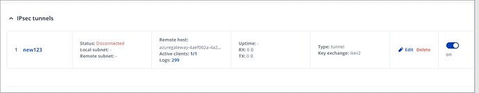

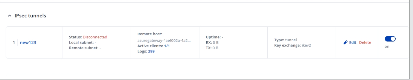

and on RUT i selected this:

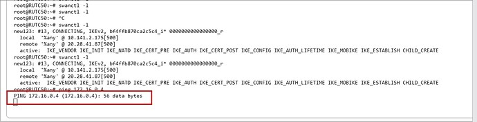

now im getting this

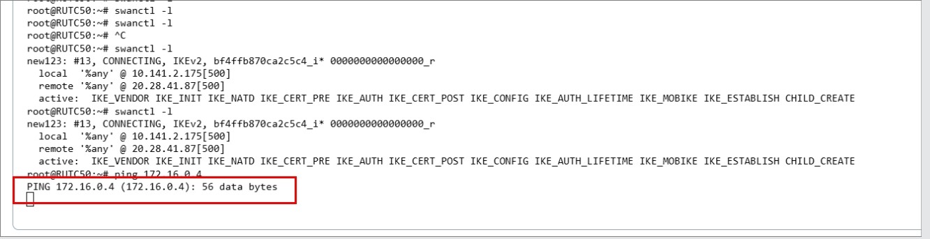

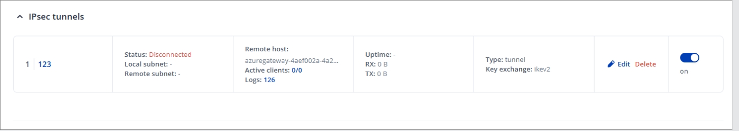

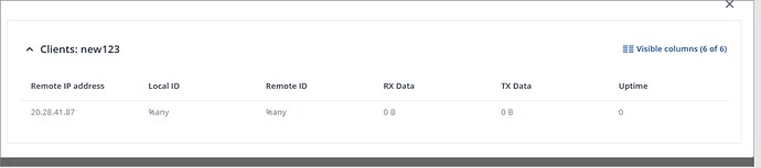

From the screenshot you provided, I can see that the status is displayed as Connected. Could you please confirm if the issue with the swanctl -l command is now resolved?
not much luck, unsure if its misconfigured or what.. its working fine on windows thou..
the issue is it keeps dropping and even when it connects slightly for 1-3seconds i cant ping my VM on 172.16.0.4
any ideas from reading the logs ?
