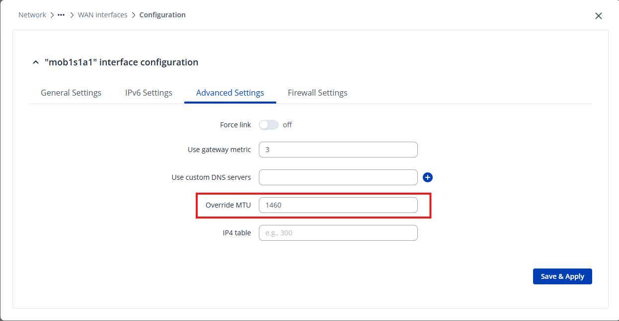

After reviewing your description, it appears that the issue is likely related to the application itself. However, from the device side, as a last troubleshooting step, you may try adjusting the MTU settings on the mobile WAN interface.
MTU controls packet size and is typically set to 1500 by default. For testing purposes, you can try lowering it to values such as 1460, 1420, or 1380 and observe whether this has any impact on performance. To modify this setting, navigate to Network → WAN, edit the mob1s1a1 interface, open Advanced settings, and adjust the Override MTU value as shown in the screenshot.

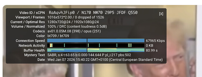

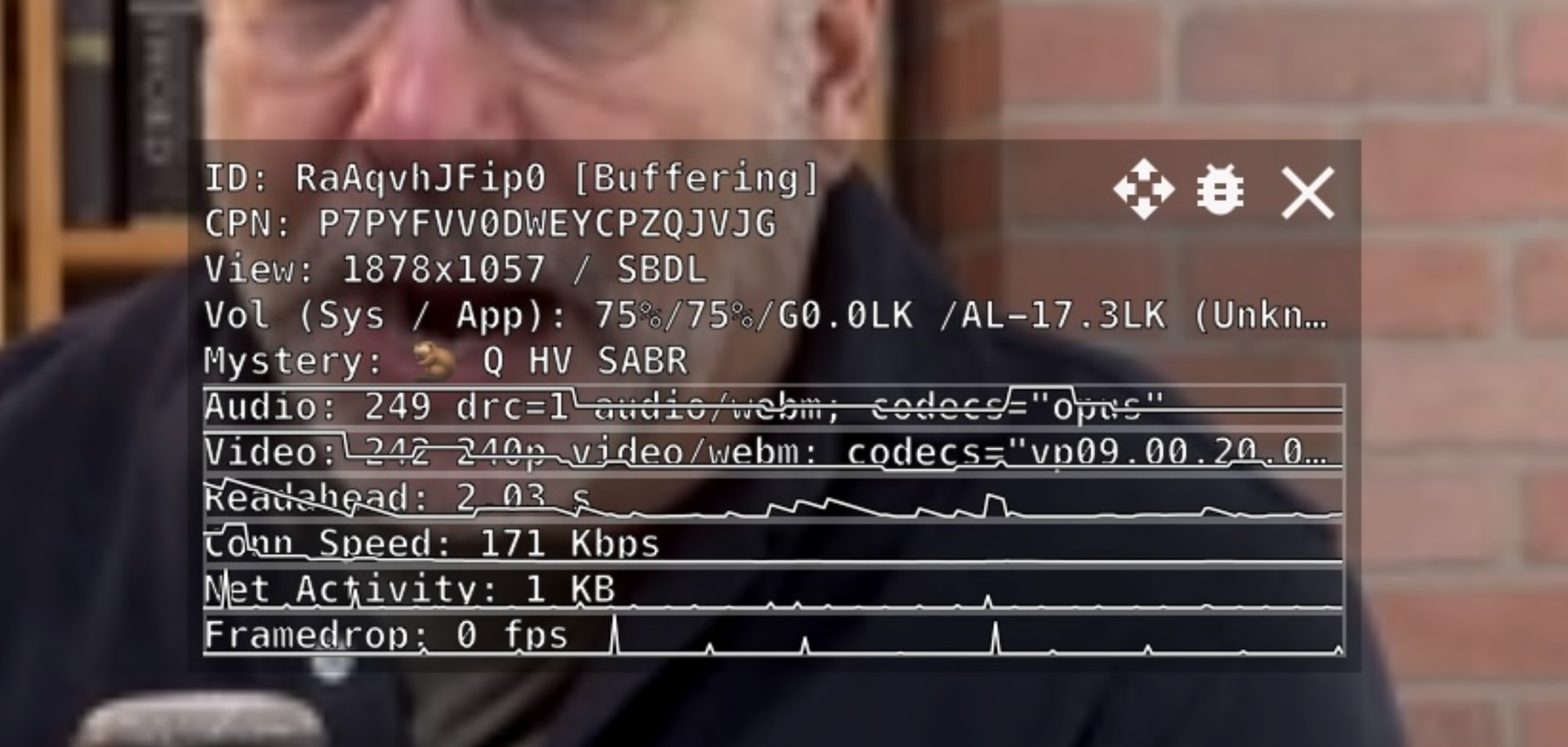

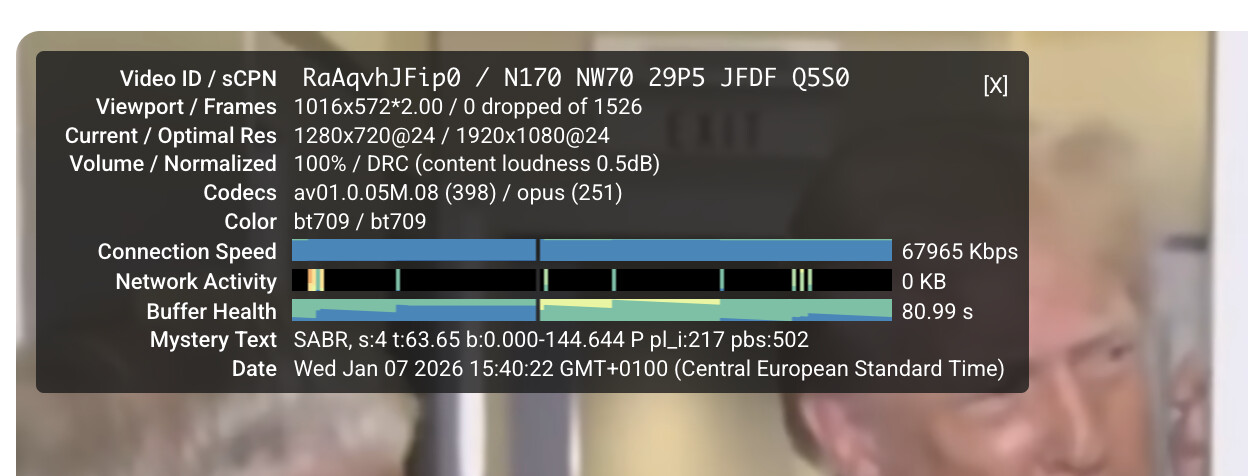

So I played a identical video almost at the same time with the laptop and the iPad with Stats for Nerds active. Both are connected to the 5GHz WiFi network on the RUTC50.
Laptop
iPad
The speed difference is crazy between 170 and 300 Kbps for the iPad and more then 65000 Kbps for the laptop.
I can’t understand why this is.

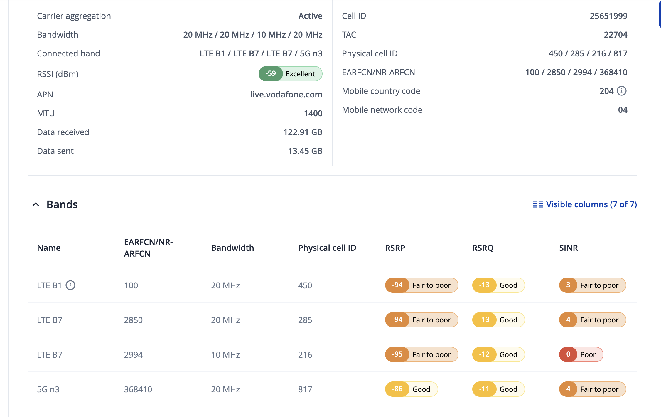

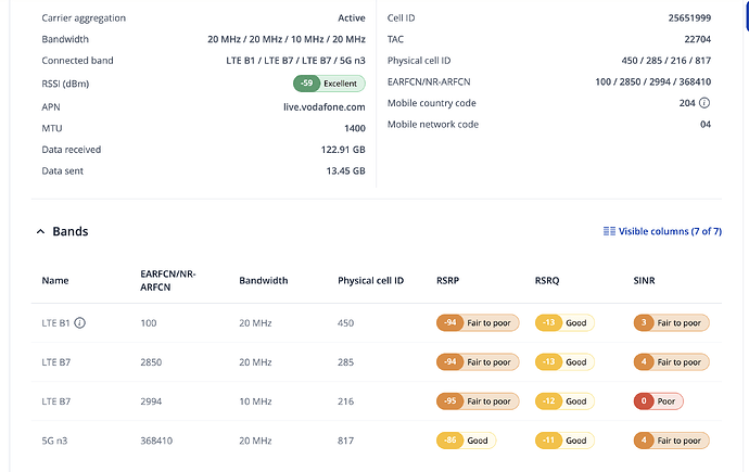

I managed to test the system with a Vodafone NL SIM.
This “solves” the problem. The signal strength seems a bit lower overall but the apps are working as they should. See below.
