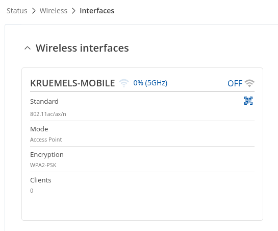

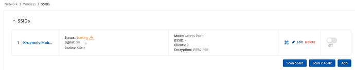

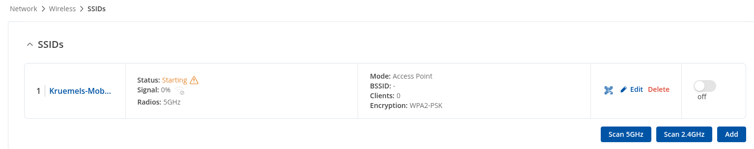

Here are some screenshots. If you need more/specific ones, let me know…
