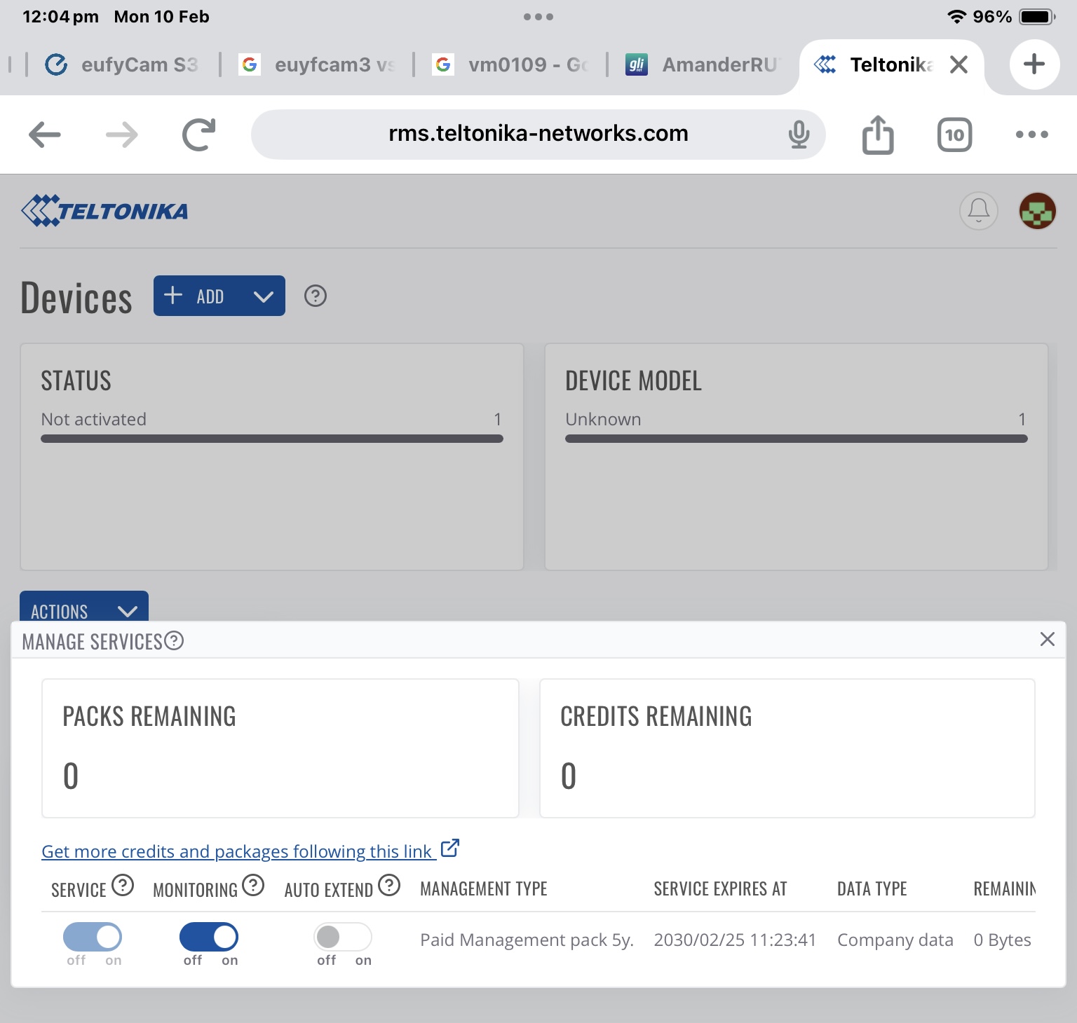

Says “Not Activated”
The Internet connection at both ends is Starlink & very stable.

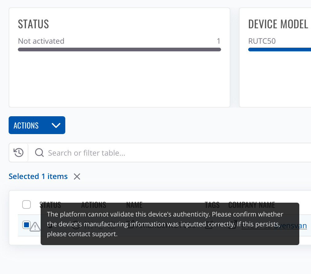

Thank you for providing the screenshots. Could you please try unregistering and re-registering the device in RMS to verify if the warning regarding device validation is resolved?
If the warning disappears but the device is still not activated, you can activate it via the WebUI by navigating to Services → Cloud Solutions → RMS and pressing the Connect button. Alternatively, you can connect the device to RMS by sending an SMS message <WebUI_password> rms_connect to the phone number of the SIM card in your RUTC50.
Please let me know how it goes and if you require further assistance.

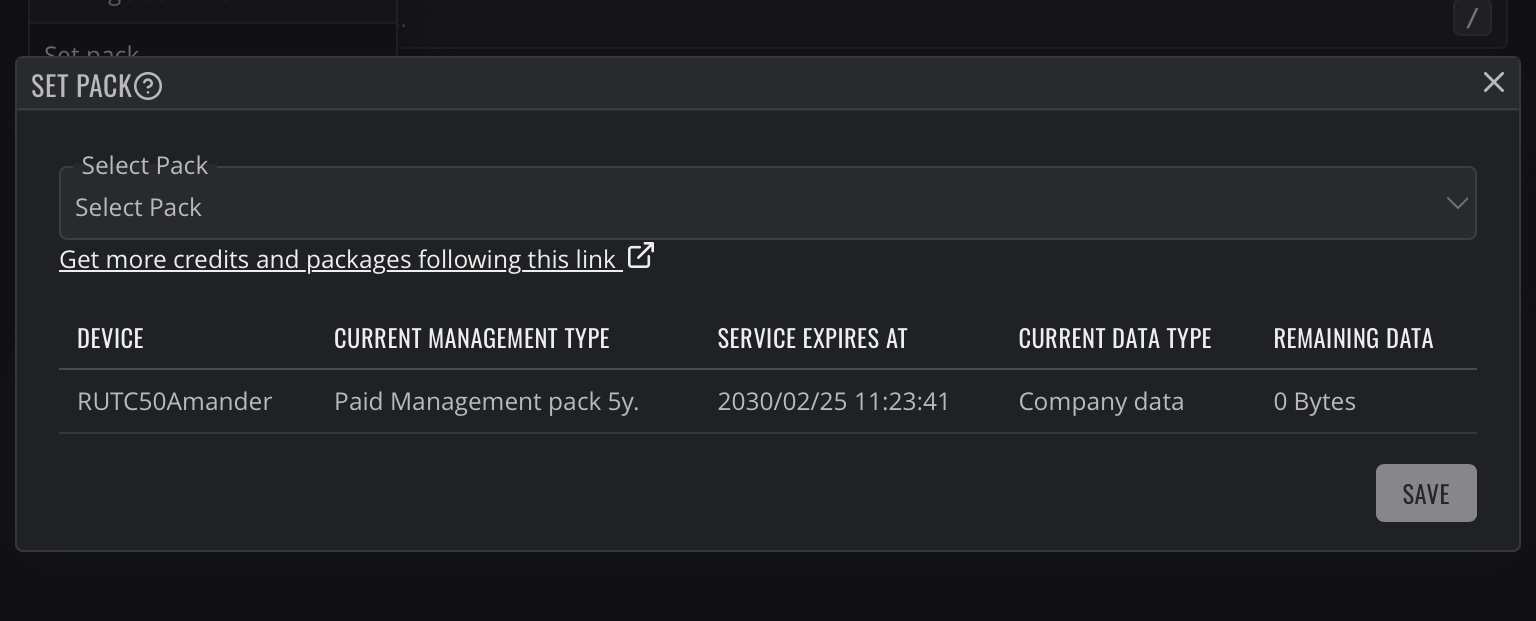

I had tried unregistering and re-registering the device in RMS about 4 times. I have just done it again & the warning regarding device validation remains. Still showing a 5 yr pack against the device but it’s not activating.

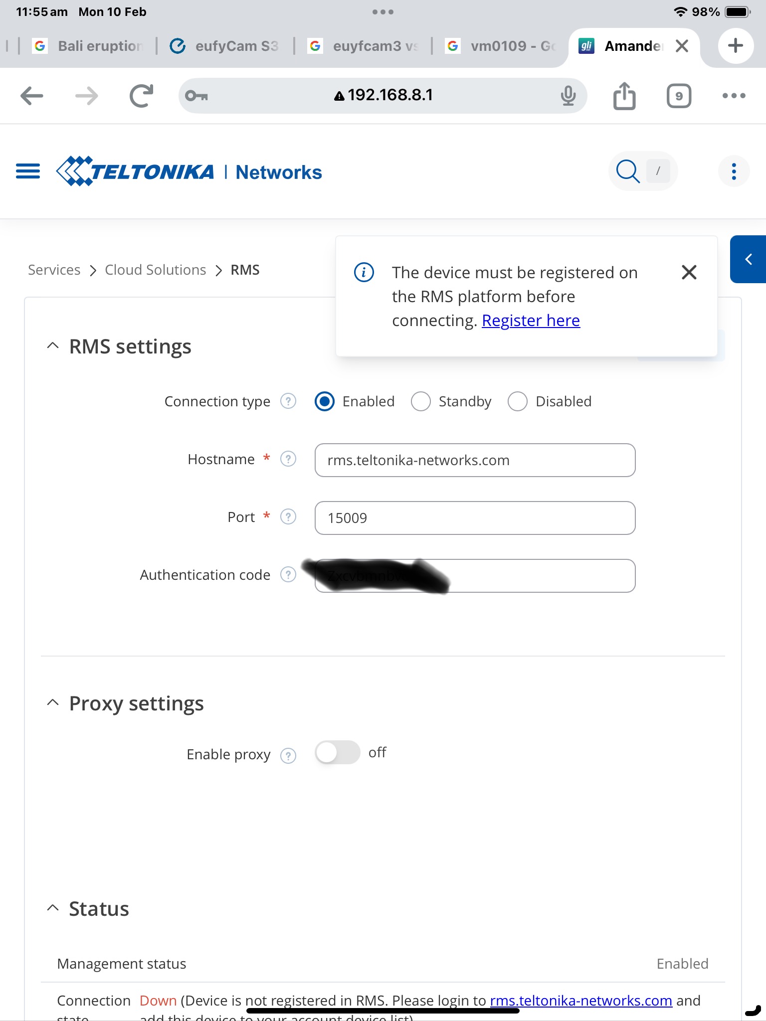

Thank you for trying that. Could you please let me know what message is displayed next to Connection State in Services → Cloud Solutions → RMS in WebUI?
Connection State is down with a message to add it to RMS
(Which I’ve added & removed A few times now)

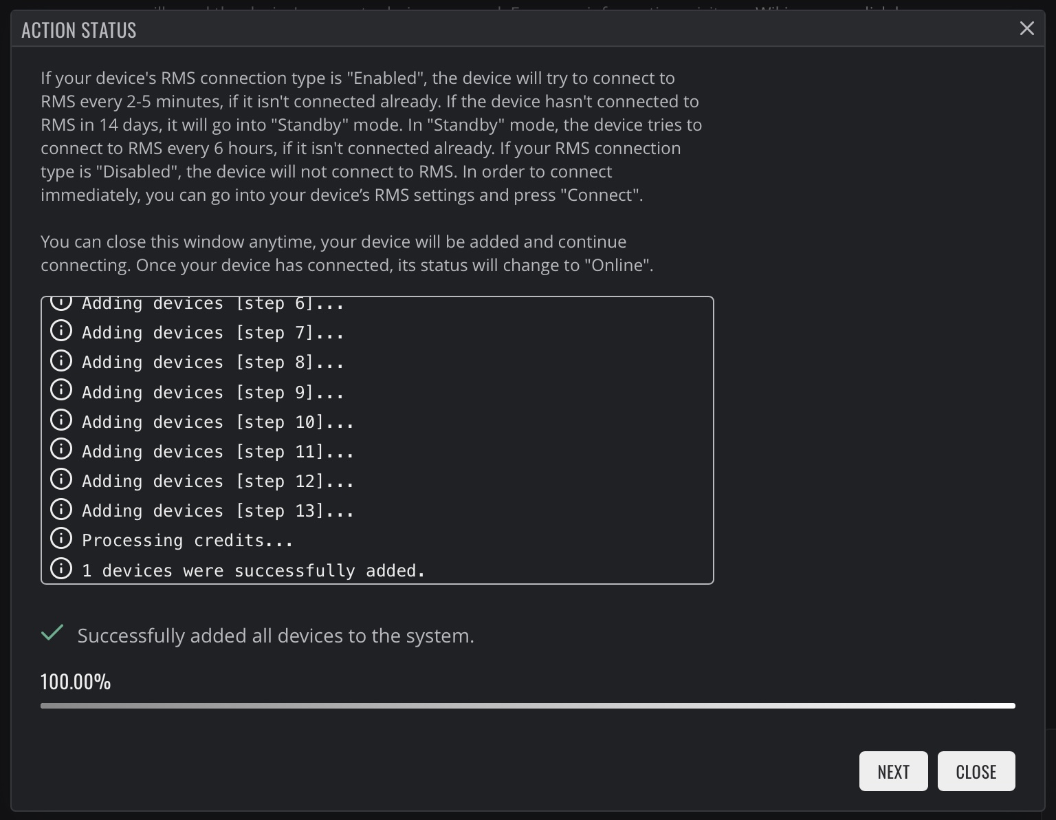

I removed & added it again. See images below.

Device is registered on RMS & has a pack allocated.
Device settings say it needs to be registered…
Have tried deleting & re registering a few times.
Checked MAC address is local.
I assume the device password needed for RMS is the Authentication code shown below. Is this correct?
RUTC50 says it connects
