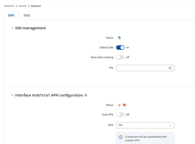

I’ve set a manual APN and have verified this type of SIM in another device.

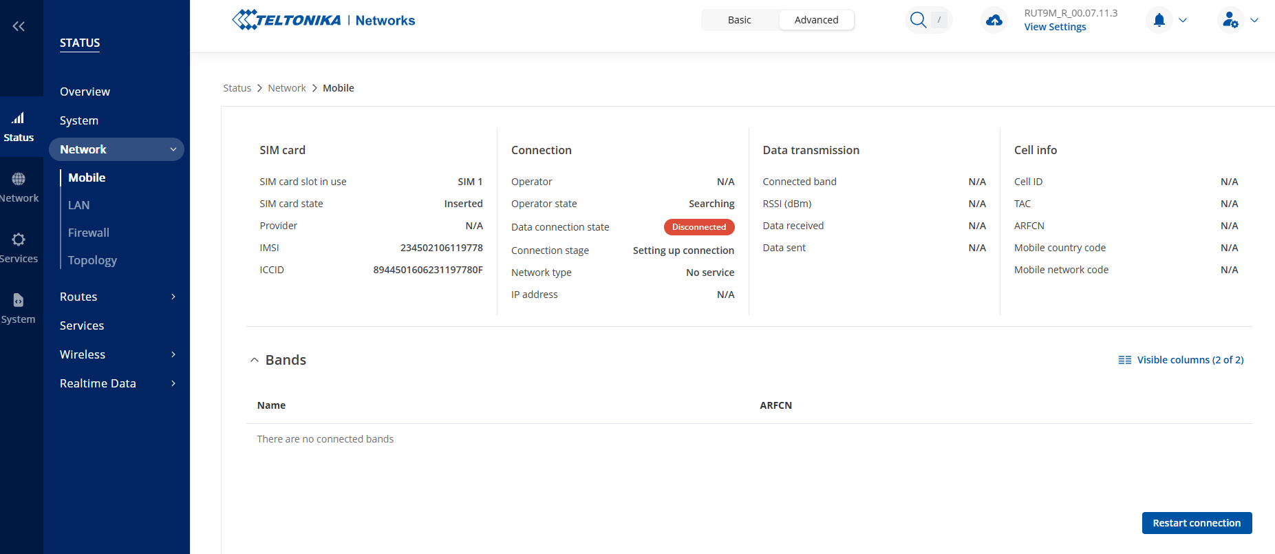

  2. Please share a screenshot of Status → Network → Mobile from WebUI.

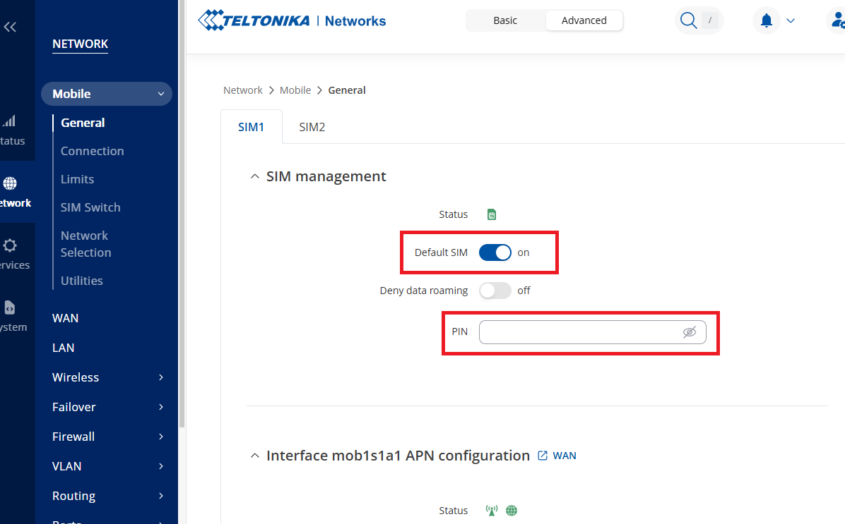

  3. Could you confirm if the default SIM is correctly selected in Network → Mobile → General?
  • If the SIM is inserted in SIM1, ensure that SIM1 is set as the default (same for SIM2 if inserted there).
  • Also, check if the SIM requires a PIN. If it does, please enter it in the same section:
both antenna were connected and I haven’t used SIM PINs on these devices.
thanks again
