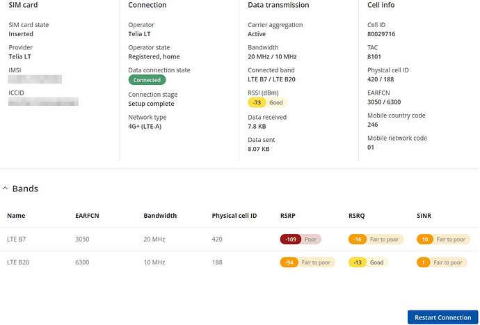

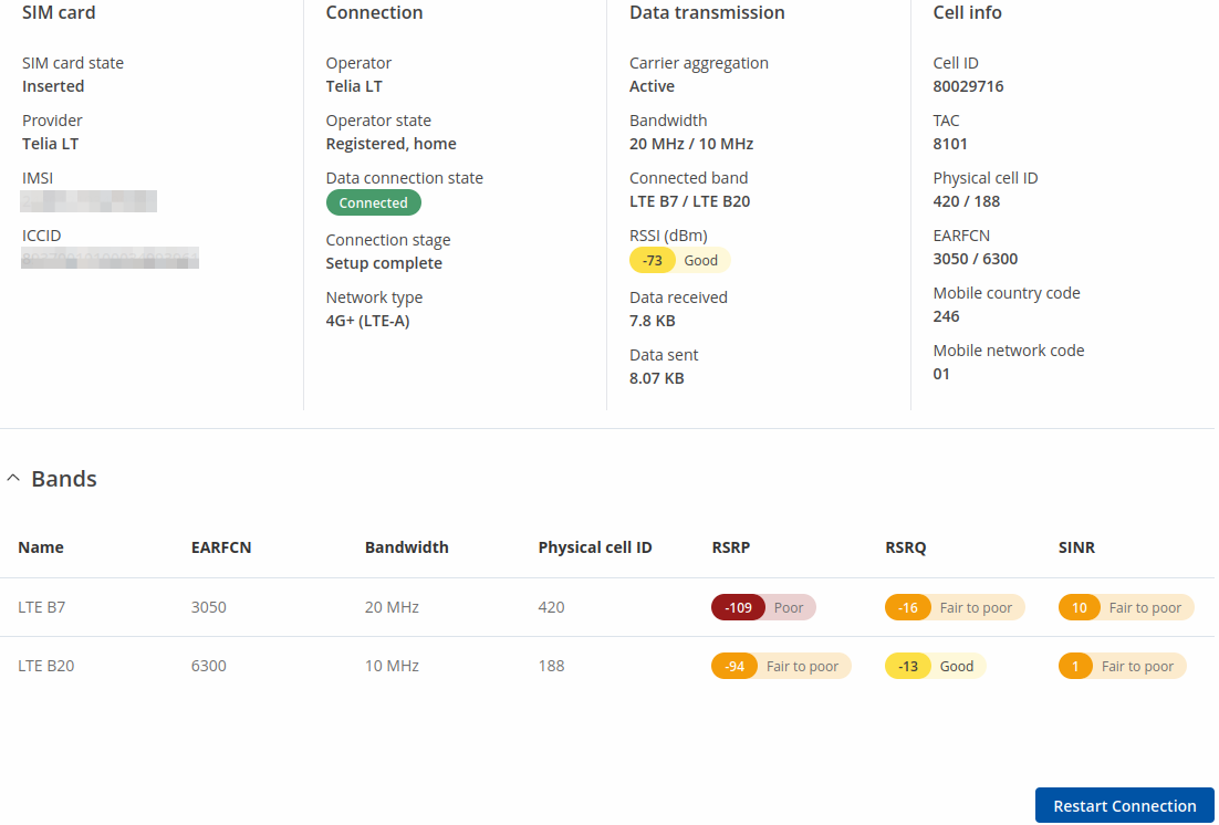

Can you share the screen about the status of sim card?

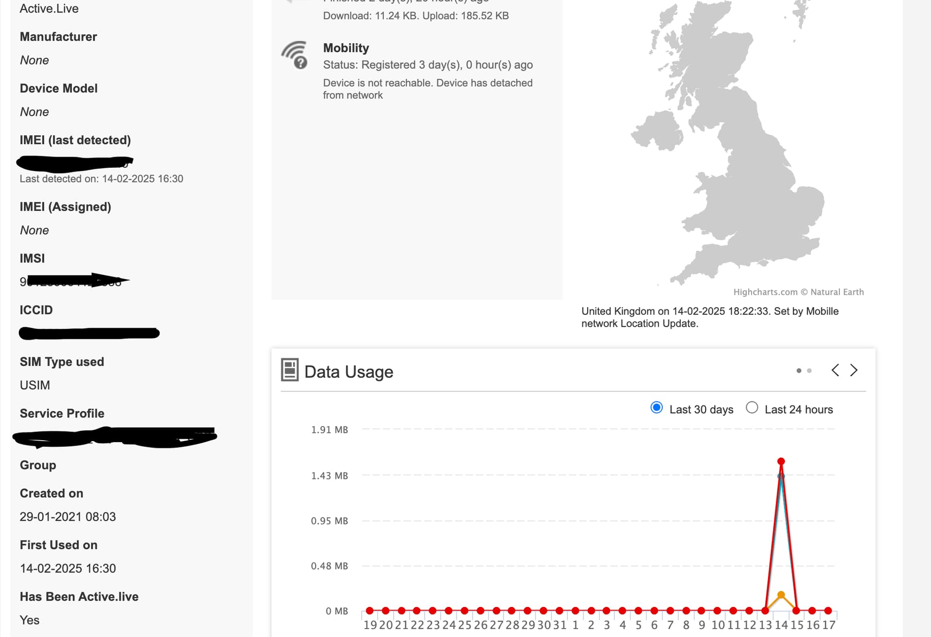

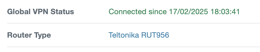

ahh sorry, This is via the SIM tab via the router, i cant login to the router unfortunatley. even though its online & connected.

The sim card status… ( Sample I share with yout ) provide some troubleshooting about LTE BAND signal.
