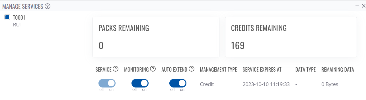

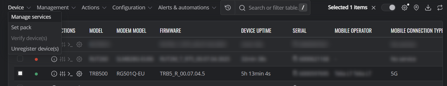

Could you make sure that the service for this device is active? This can be done by logging into your RMS account, select the RUT956, and in the Device drop-down menu select Manage services:
Make sure that the Service option is enabled:
If you’d like to apply the credits to this device automatically, enable the Auto Extend feature.

I have RMS credits in my account, and service option is enabled.
