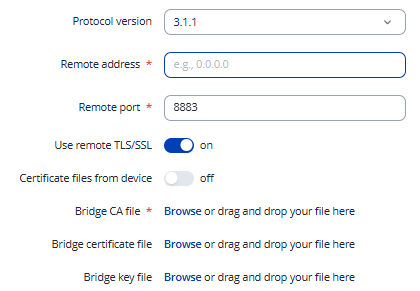

We have acquired numerous “RUT956/RUT260” devices over the years, as security rules have become more restrictive.
The “MQTTS” protocol is required by the IT department, but the “MQTT message: remote address” field does not allow a DNS name to be entered.
What is the procedure for enabling an “MQTT bridge” with a DNS address?
Thank you in advance for your support.

Actually, the firmware router is “RUT9M_R_00.07.20.3”.
For Bridge :
No error if I write an “IP address” ou “DNS name” on “Remote address*”
  • Remote address* : / port : 8883 / Encryption (TLS) = Connexion NOK
  • I don’t use “Bridge CA file”
I check the connectivity with an tool like “MQTT Explorer”.
  • Host : / port : 8883 / Encryption (TLS) [no certificats] = Connexion OK
I need a safety connexion by “MQTT” like “MQTTS” between the route “RUT/Bridge” and a “MQTT Broker” server directly.
