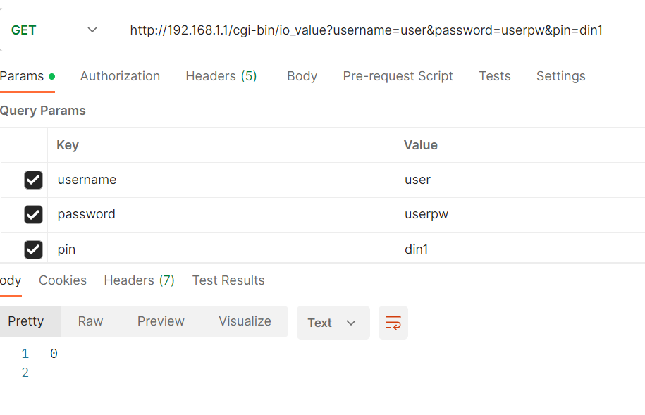

Have enabled Post/Get on Input/Output service. Retry the GET request.
Have found that when I request din2, I get the state of “digital input”. If I invert digital input in UI output from get din2 switches.
Would have expected that “digital input” would effect din1 and “isolated input” would effect din2, just as on mqtt the messages is “digital1” for “digital input” and “digital2” for “isolated input”.
Have tried get request on the entire list “Available IO’s: acl0 adc0 din1 din2 dout1 dout2 iio relay0”, and cannot see that any of those represent state of “isolated input”
And did again install mqtt service, and reproduced that unit would respond with N/A on requesting digital1 or digital2
(Great that old comunity can be accesed again)
I tried suggestion in old thread, and did the same test, still looks to me as though responce on requesting din2 corresponds to “Digital input” and not “Isolated input”, and responce on requesting din1 always return 0.

INVERSION OFF:
INVERSION ON
INVERSION ON (On “digital input”, and not “isolated input”)

We’ve identified the MQTT issue. It will be fixed with the v7.5 release.
As for the pin names, Isolated input is named iio, and all of the names can be found in this section: RUT956 Input/Output - Teltonika Networks Wiki
Sorry for the confusion on the last post.
