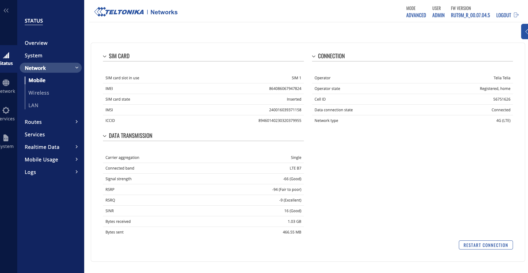

In order to understand the issue better, I will ask you to provide some information. Please navigate to Status → Network → Mobile, and take the screenshot of the page. This will provide the information about the signal parameters and the modem.

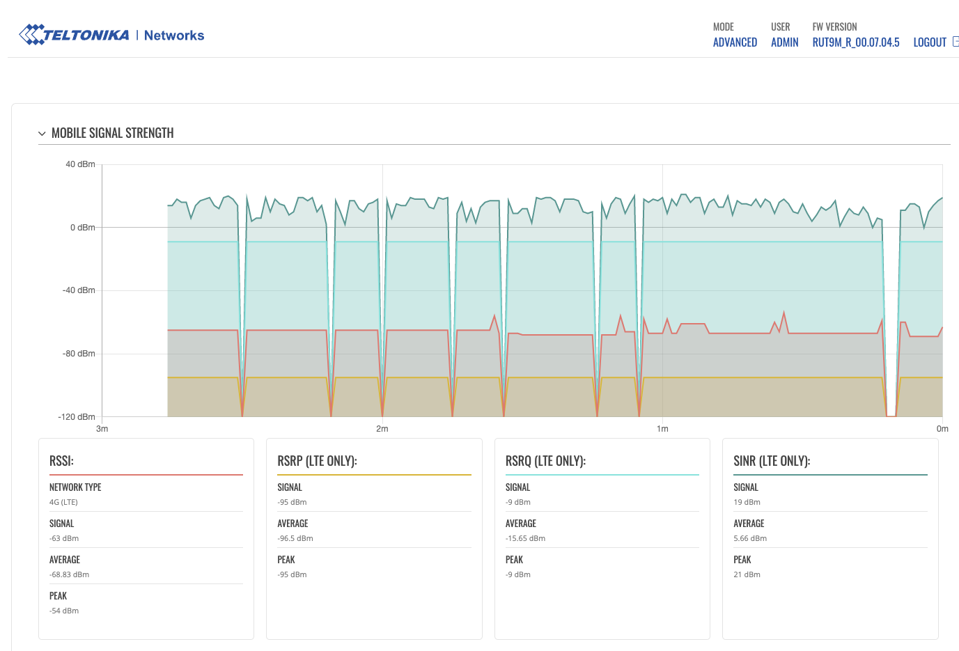

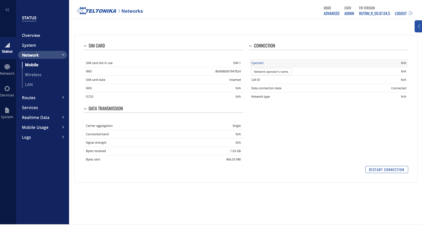

I took a screenshot at the page you asked for. But when one of these drops happen, the screen clears of information. I took a screenshot of that as well.
I cant see anything interesting in the logs. The drops happen every other minute or more, but there’s nothing unusual in the log what I can see.
I’ll also try to move the router over the weekend to see if it’s a coverage problem, but I’m using my phone without any apparent problems, so I don’t think so.

This is just a visual bug where the information disappears for a short time. Could you try running a ping test for a few minutes and check if there is an actual connection loss during the time information disappears in the mobile signal graphs?
On Windows, you can run the command ping 1.1.1.1 -t for infinite pings to the host 1.1.1.1. If you don’t notice any lost pings, the issue can be disregarded. However, if you do notice some missing pings please paste the output of the ping test.
