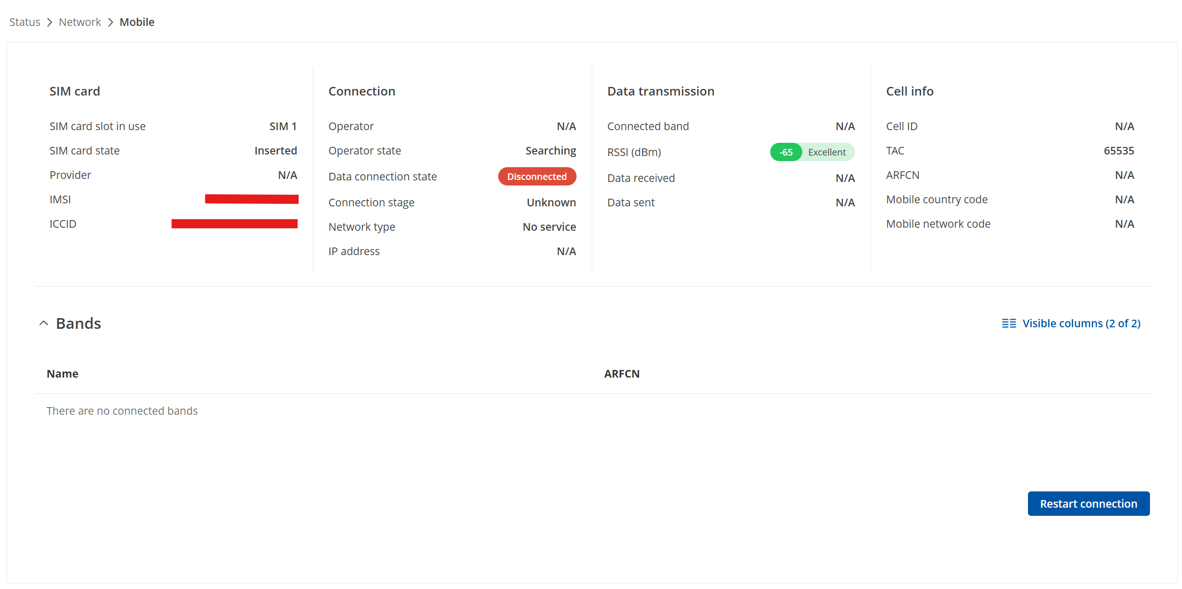

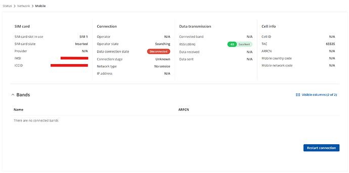

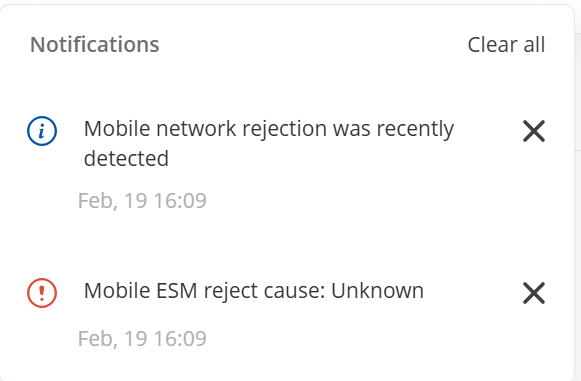

Here are some screenshots for your reference-

I have currently set the APN to Auto. And I switched the PDP type to IPv4 and then did a reboot, still no help.
The message… " Mobile Network Rejection " is strange…
