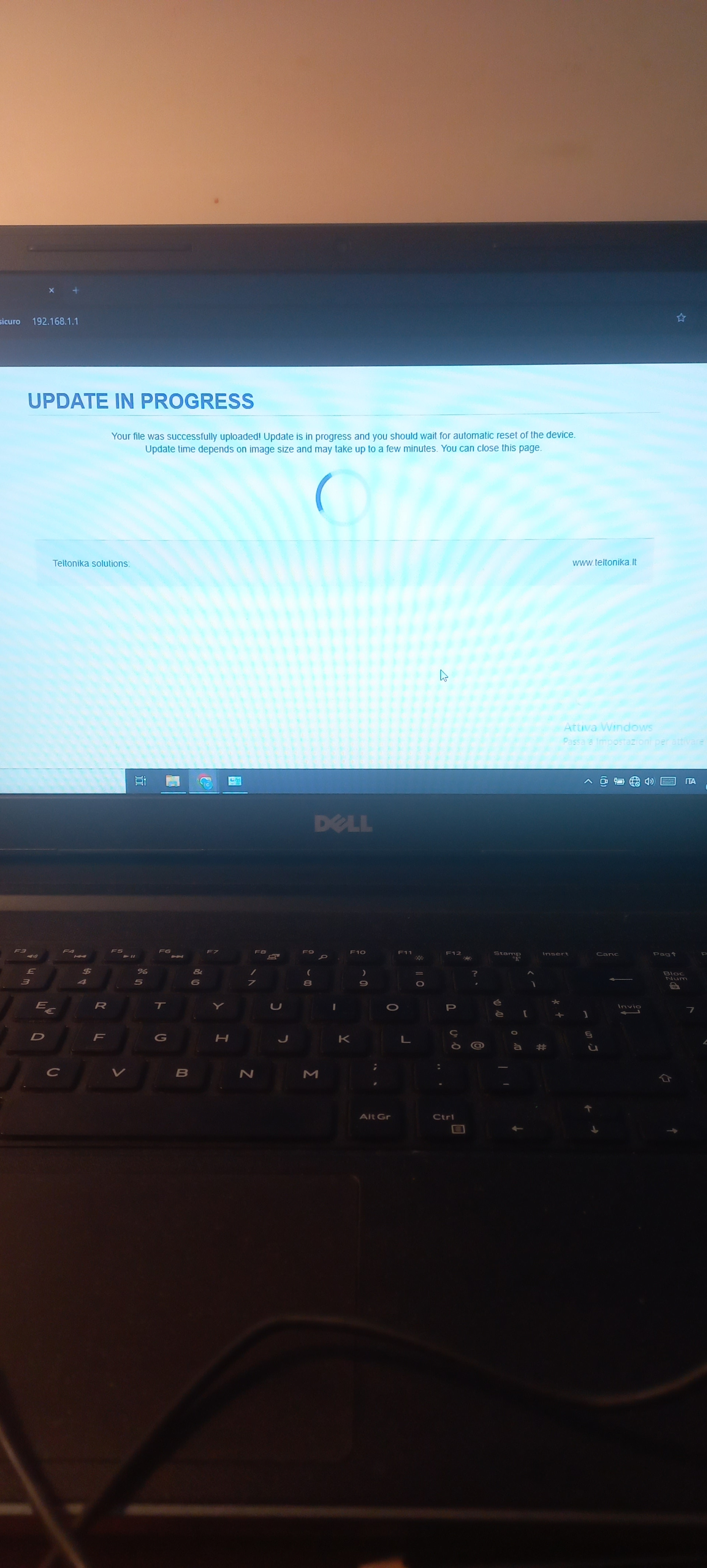

Hello. First I never update my Rut955. Today I try to update the firmware to the version R 00.07.06.17. Nothing to do . I have UPDATE IN PROGRESS . It might be an AUTOMATIC RESET of the device? What time must wait? Thanks for your help

I have removed the screenshot you shared, as it contained sensitive information (IMEI and serial number). Please keep in mind that this is a public forum, and we kindly ask users to avoid posting any confidential or device-specific details publicly.
Under normal circumstances, a firmware update may take several minutes to complete. However, if the device appears to be stuck or the update does not finish successfully, I would recommend reinstalling the firmware using the bootloader menu. This recovery method will fully erase the existing firmware and configuration and then perform a clean firmware installation.

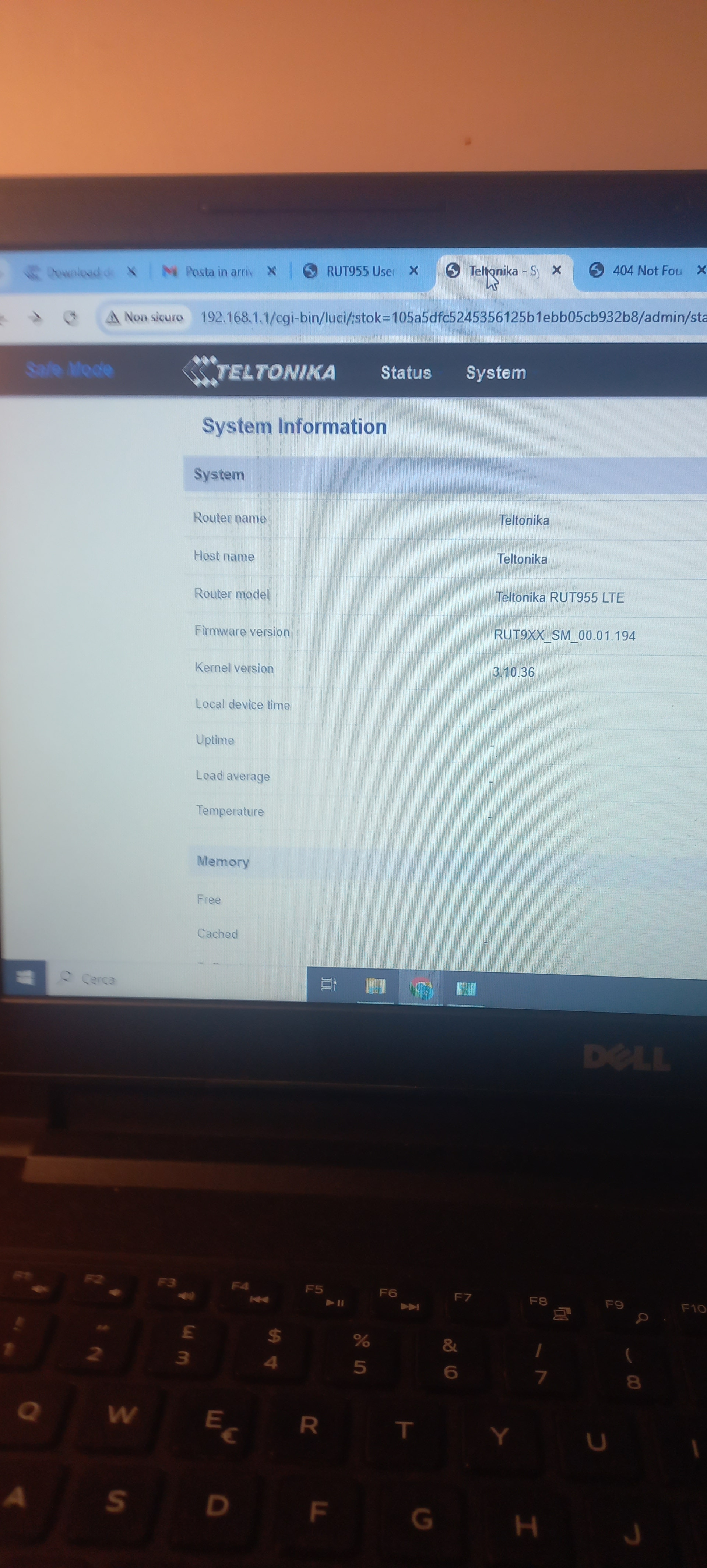

The device is not reachable Webui.I update to the version R.00.06.09.5 from file. The rut has an partially wake up but the modem and mobile doesn’t work. I try to update to version R_00.07.06.20 . The router respond that can’t be upgrated to a firmware newer than RUT9XX_R_ 00.07.00

If the device’s WebUI is not accessible, as a last-resort recovery option you can try reinstalling the firmware using the bootloader menu. This method performs a clean firmware installation and can help recover devices that are otherwise unreachable via the WebUI.
Please note that the RUT955 is an End-of-Life (EoL) device, and the latest supported firmware version for this model is R_00.07.06.20. Newer 00.07.XX firmware releases are not compatible with this device and cannot be installed.
