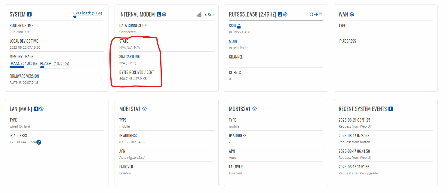

Some screenshots on current status when acting bad included.

From the logs, it seems like the internal modem of the RUT955 stops responding. This could indicate a hardware failure, however, it’s too early to say if this is the case here.
In the firmware page, could you check if there is an update available for the internal modem? This might help with the issue.
Another thing you could try is factory resetting the device, as this would mitigate any issues caused by the configuration.
Finally, perhaps you have a different SIM card to test in this device to check if the issue reoccurs?
