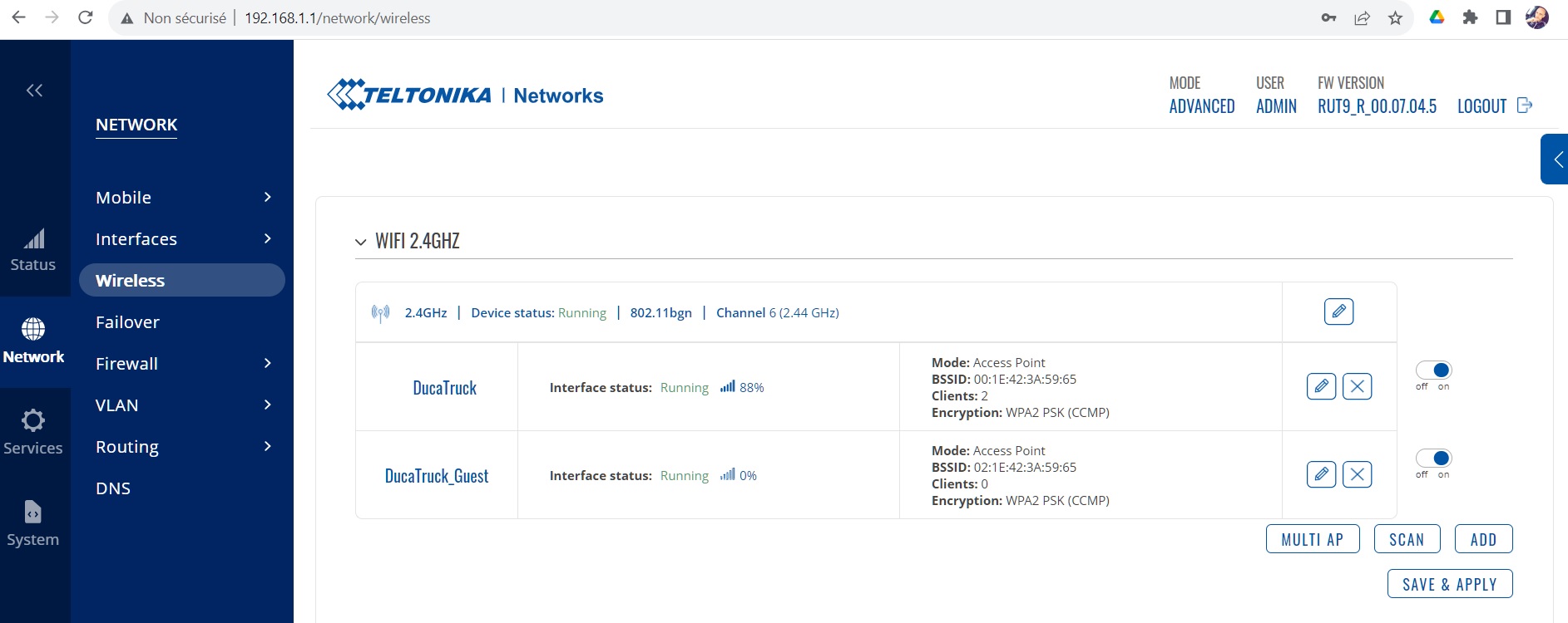

Hello, and thanks.
I have tried 2 options, with backup file and without, configure everything manually. and same result.
Network wireless page:
The message appears permanently and repeatedly in the overview window.

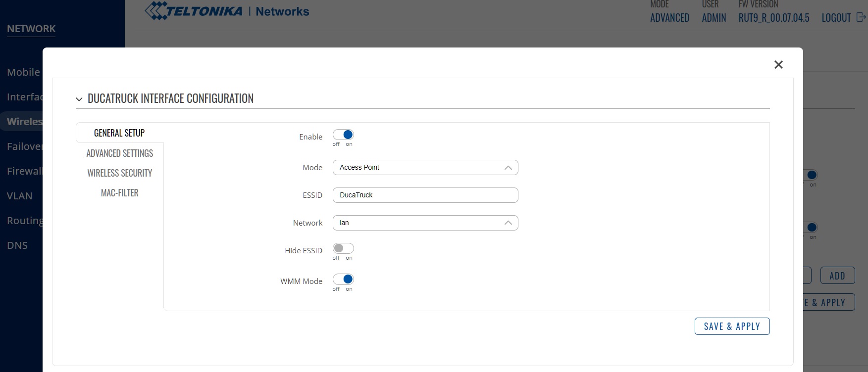

And the configuration of each access point is the same:
