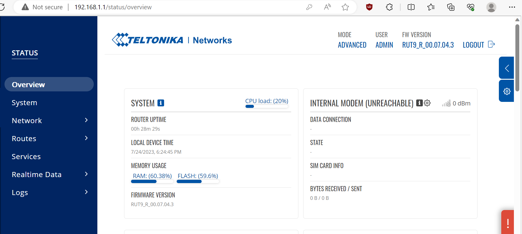

Tried updating but suddenly got interrupted and now the modem is not accessible.
Is there a command to reset the modem?
/Ulf

running this command does not seem to show the device at all.
Is there a way to reset the box or any other way to get back to factory default?
/Ulf
