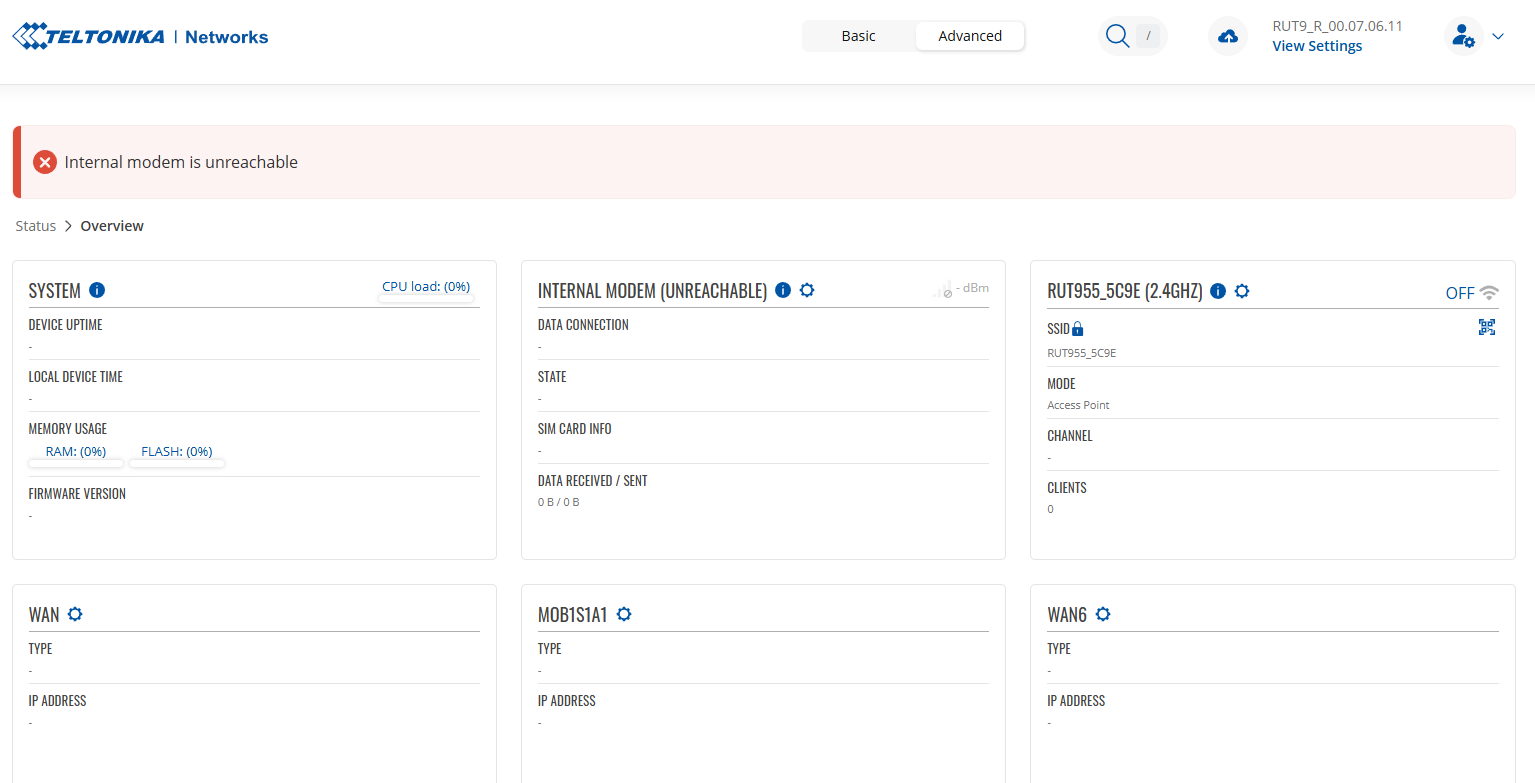

RUT955 modem keeps on rebooting

root@MSP9220:~# lsusb
Bus 001 Device 001: ID 1d6b:0002
Bus 001 Device 003: ID 04b4:0006
Bus 001 Device 002: ID 05e3:0610
Bus 001 Device 004: ID 2c7c:0125
root@MSP9220:~#
This is everything I get out of the CLI is this still recoverable?
Unfortunately, if there is no 9008 number shown in the lsusb output, it means that the modem is not recoverable. If your device is still under warranty, please contact your distributor to begin the RMA process.
We appreciate your understanding.
Hi
Thank you for the response, topic can be closed for me
