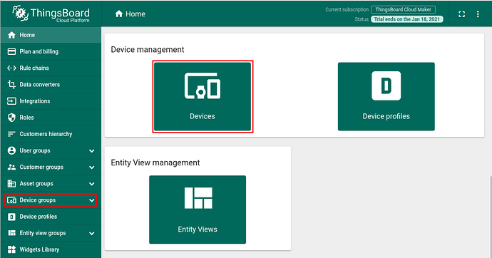

As an example for Data to Server feature, we can suggest using the Thingsboard IoT Platform, which facilitates device connectivity via standard IoT protocols such as MQTT, CoAP, and HTTP. This platform supports both cloud and on-premises deployments. You can find more information about integrating RUT955 with Thingsboard at the following link:
