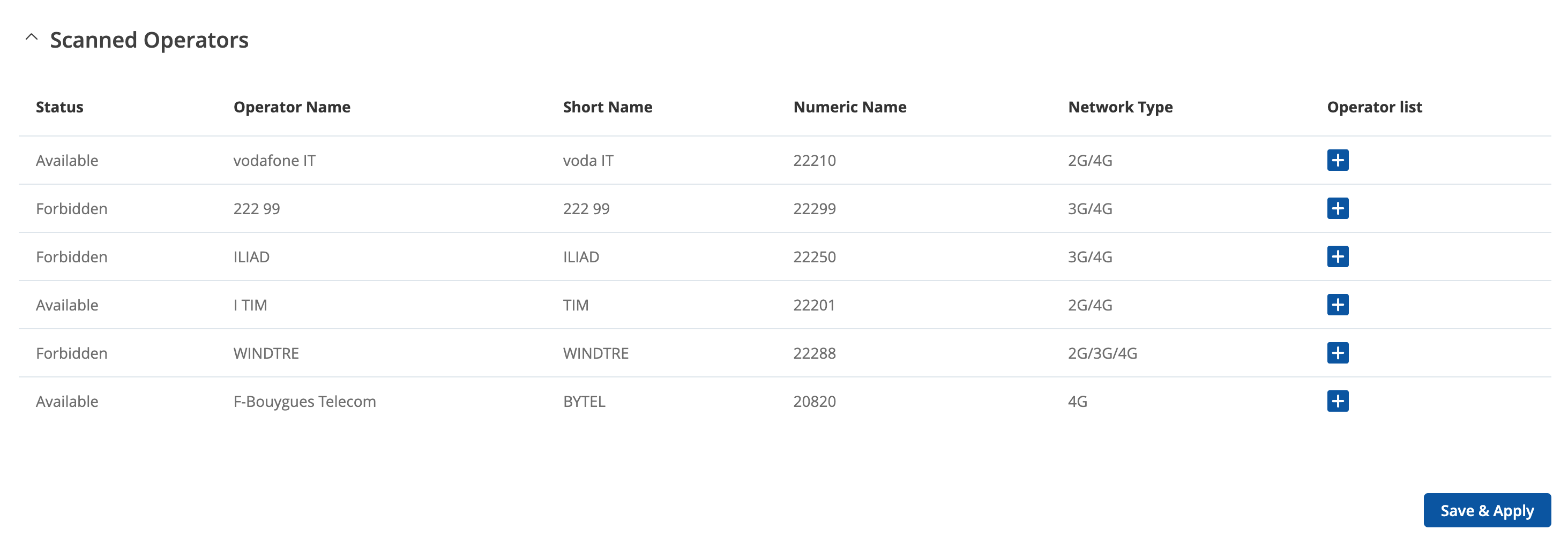

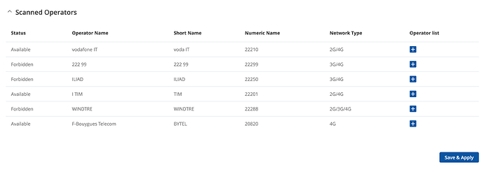

  • I ran operator search and it found multiple operators

Hi Arturas,
thanks for your swift reply.
Rest assured that the device has good coverage. I don’t see why Band Lock should help.. I had let it search operators for more than a day before (and also the Operator Search finds the cells).
So you are suggesting to upgrade the firmware (did so ~1 month ago, but probably there is a newer one available). Any specific reason, why you suggest teh bootloader method? Or can I download the file and upload it via the WEBUI as well?
Steffen

Dear Arturas,
Thanks for getting back to the topic.
I installed (via WebUI) the one firmware update that was available few weeks back, but nothing changed.
Otherwise it is still the same - operator scan finds all the network, but I can’t attach to any of them (also verified from emnify side that there is absolutely no signaling coming from the modem).
What else can I reset beyond the factory reset? I’m currently on a trip but want to check again in 2-3 weeks when I’m back.
Steffen

Yes I have 2 other local SIMs that have no PIN and work in other devices (and used to work in the RUT955 before).
I have multiple antennas and good reception, but I never get connected.
I will try the bootloader reset as soon as I’m back.
