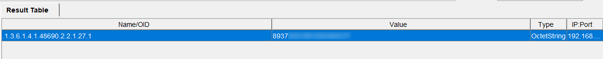

I was successfully able to obtain mICCID value using OID .1.3.6.1.4.1.48690.2.2.1.27:
Make sure you are on the latest firmware and using the correct MIB file.
Thanks, working fine after upgrade to latest firmware RUT9_R_00.07.04.4

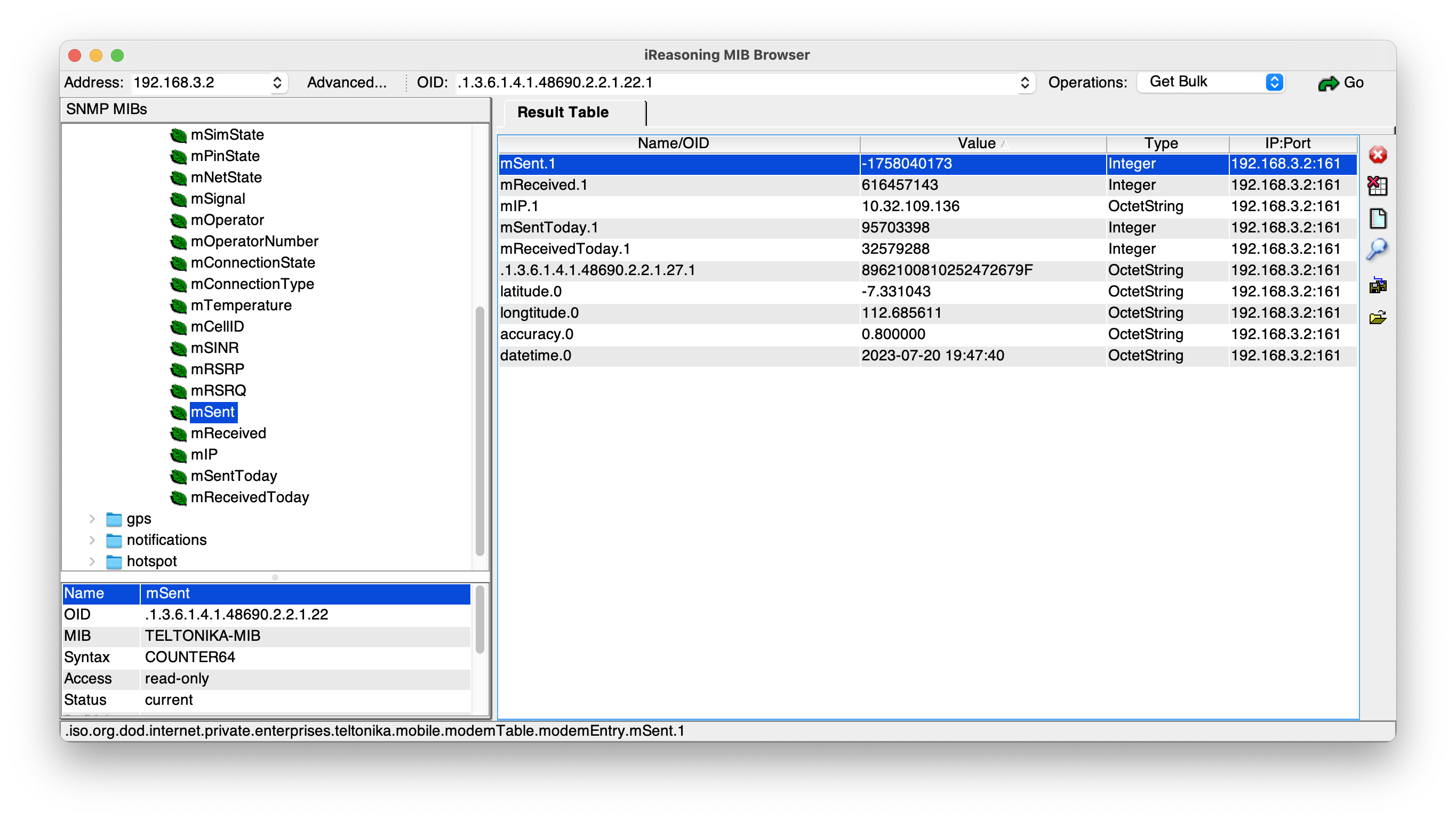

sometimes the mSent value in SNMP is negative (-) sometimes also positive (+), what causes the value to be positive and negative?
I cannot reproduce this locally, ant there seem to be no bugs reported. Are you using the MIB Browser as suggested? If so, could you check if it replicates with any other SNMP agent?
I have used MIB Browser but I got a negative value on OID 1.3.6.1.4.1.48690.2.2.1.22 (mSent) while 1.3.6.1.4.1.48690.2.2.1.22 (mReceived) got a positive value.

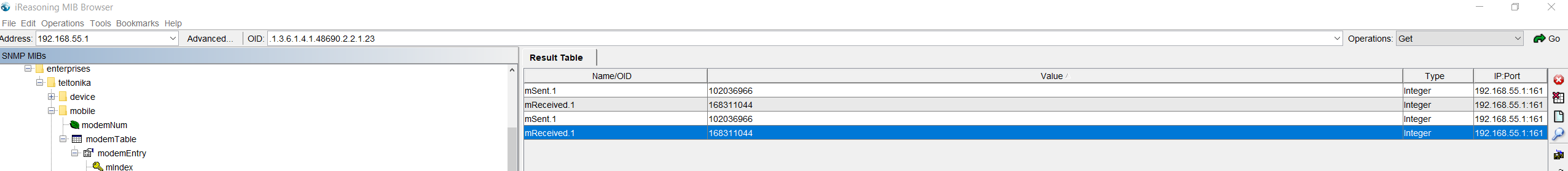

Can’t seem to replicate this locally:
And just to clarify, in both Network → Interfaces → General, and Status → Mobile Usage the mobile usage is displayed correctly? What about Status → Network → Mobile?
below for the results, the value is different

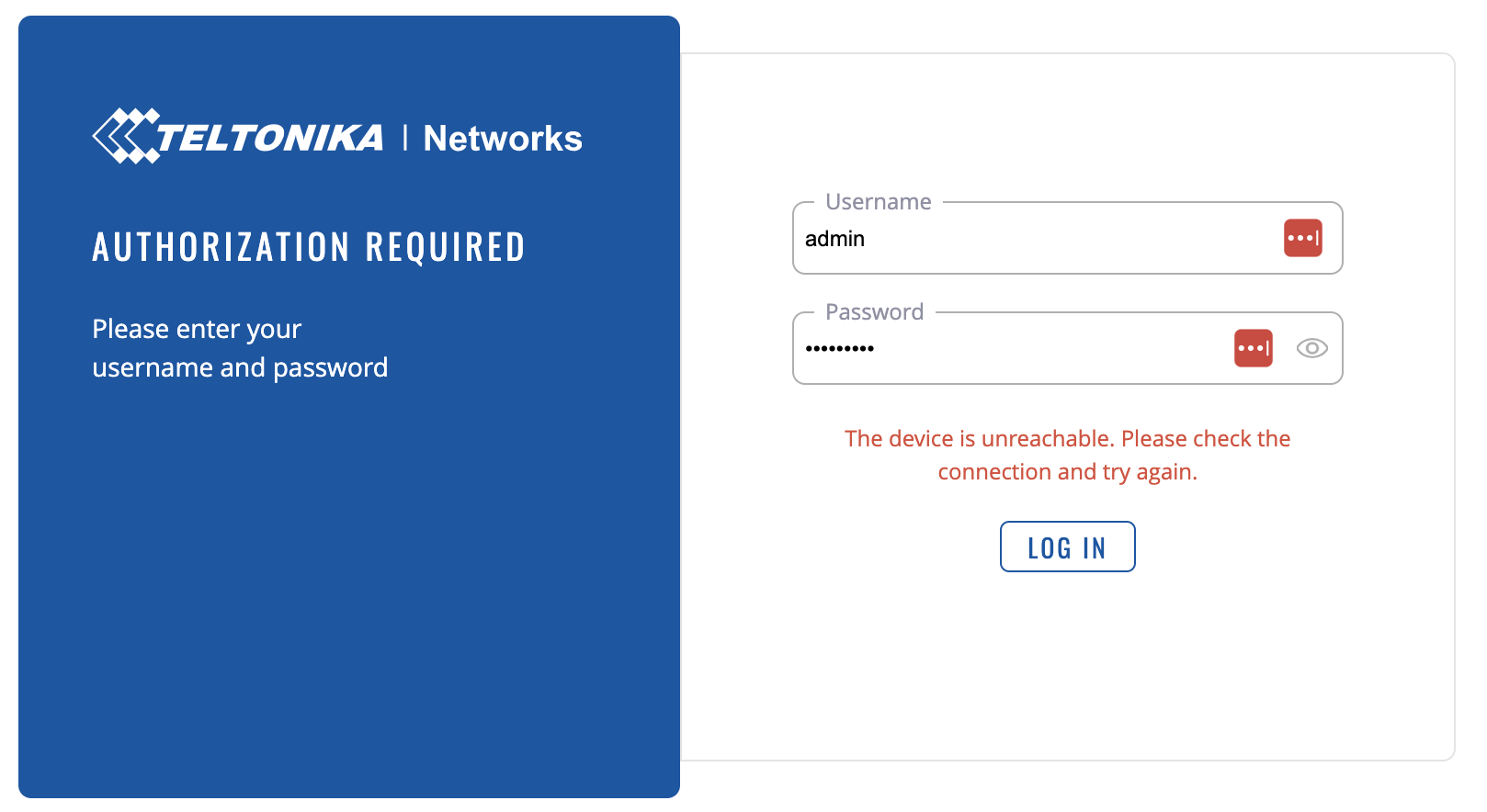

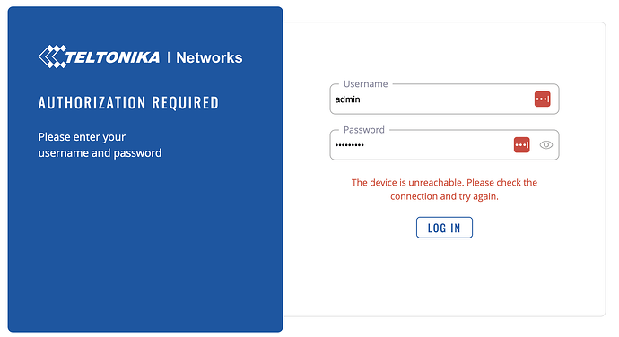

Hi, I have emailed but no response, How do I downgrade the firmware? I want to troubleshoot using the old firmware, the log appears again when the uptime is 1 day, I can’t access the web UI when this error log appears.

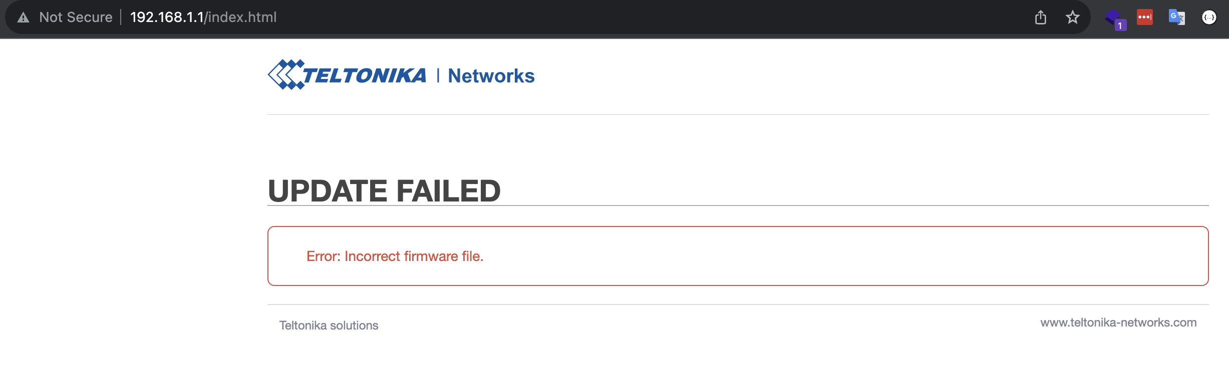

got the following error when using the firmware you provided, What is the difference between updating firmware via bootloader and via menu system → firmware → update firmware?
Perhaps you could try updating to the latest firmware available on our Wiki using the bootloader?
Flashing the firmware via the bootloader completely rewrites the internal OS files resolving any issues that might be caused by corrupt system files.
