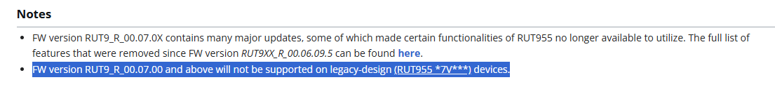

I guess that you tried uploading a firmware version newer than 7.00, which is not supported by the RUT955 *7V*** product code:
Instead, you’ll have to head to the firmware download page: RUT955 Firmware Downloads - Teltonika Networks Wiki

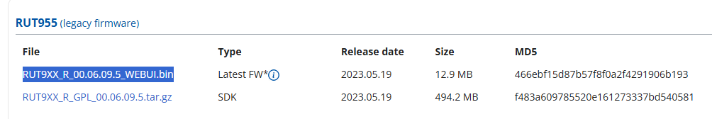

And download the legacy firmware:
Finally, just follow this process: Bootloader menu - Teltonika Networks Wiki

  1. The .tar.gz file is not what you have to upload, it must be the WEBUI.bin file.
