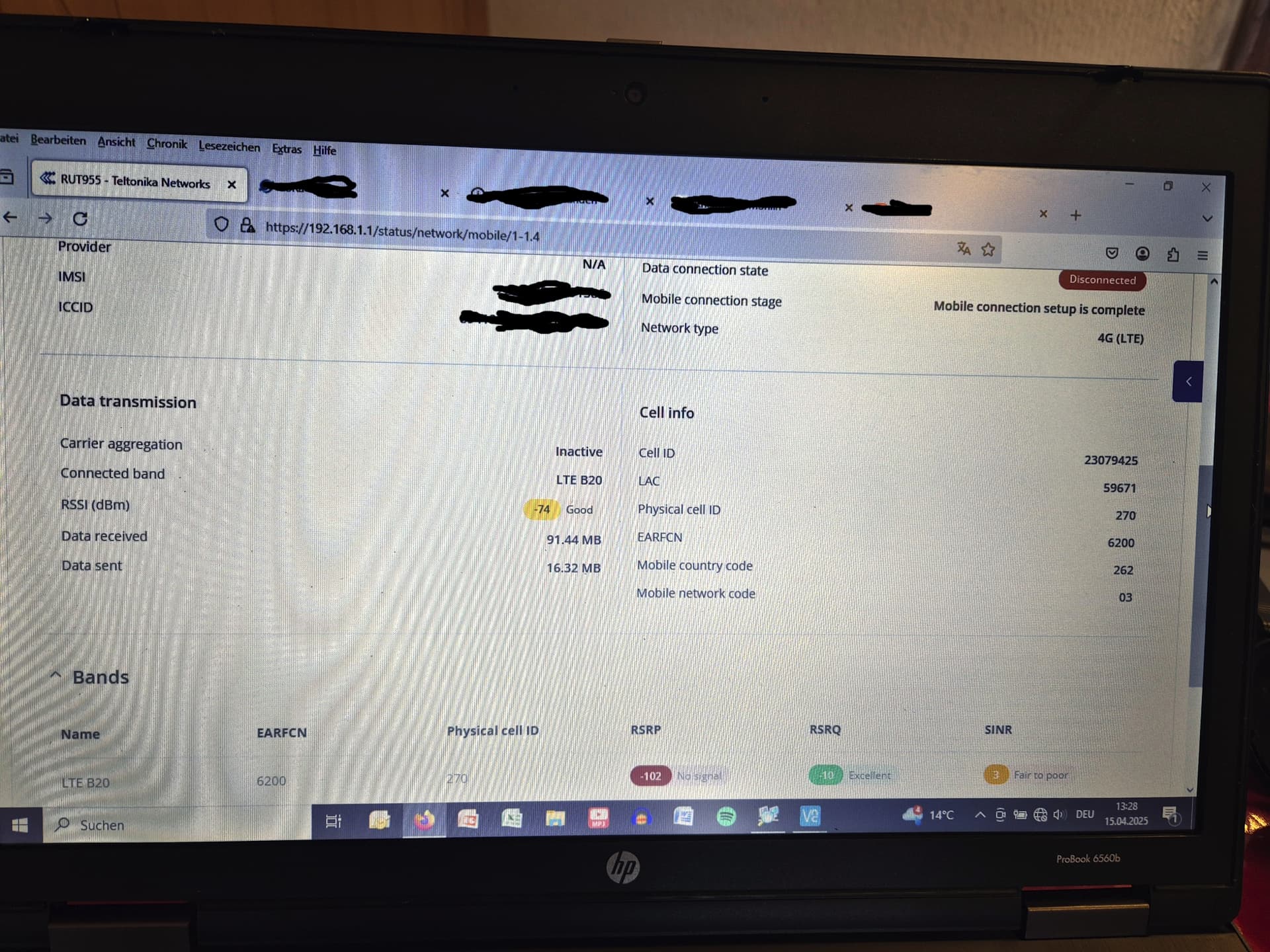

However, this is what I get the best after spent again some hours of try and error yesterdays:
RSSI seems to be quite good, but RSRP is very low, while RSRQ and SINR are ok. What can be done to improve that? The RUT was looked to band 20. Band 1 is the same but even worse, other bands are not available.

Additionally, judging from cell information, it appears that the modem is connected to a cell on Germany’s side, which is a bit weird.

…yes, I noticed the fact about being connected to germany (data-roaming is off).
However, I checked out opencellid and cellmapper in the meantime, witch give me some inputs about possible bands and antenna-directions.
I’ll make some more tests to get the latest dB’s.
