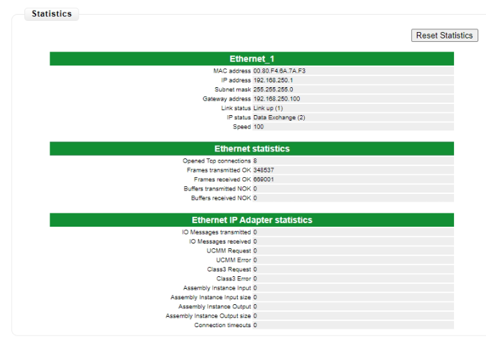

First:
RUT955 is connected to PLC through industrial switch (not managed ifself).
That is the configuration in the CPU of PLC. As you can see there is gateway IP address which is also my router Ip address (192.168.250.100).
