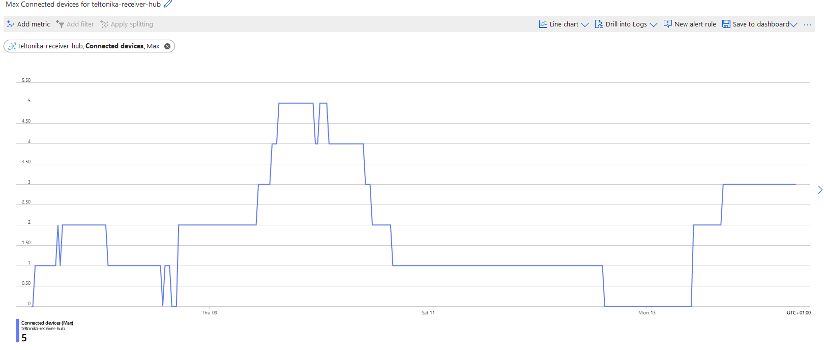

Thank you for the reply, this is a graph of the connected devices from Thursday to ;onday. On Thursday 5 devices were installed and then they dropped off one by one until the last one was disconnected on Sunday evening (the new devices on Monday has been added afterwards.)
I have tried diagnosing and looking at the logs but can’t really find anything useful there, no diagnosis can find any issue.
Could the problem have something to do with that a device loses connection and then regains it again somehow? Or if it loses power and it then goes back on, could that affect the connection between the Teltonika device and the IoT Hub?
The devices should stay connected if everything is fine. Connectivity disruptions, as well as reboots, will cause the device to disconnect. Hows connectivity on those devices? Are they using mobile connection? How’s the signal?
From the screenshots, it seems that there is no pattern to those disconnections.

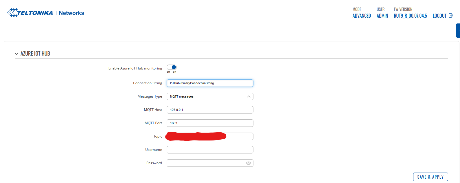

Also, could you please share your Azure configurations from RUT955? Make sure to hide sensitive information, such as connection strings.
Yes of course, here are some screenshots on the configuration on RUT 955.

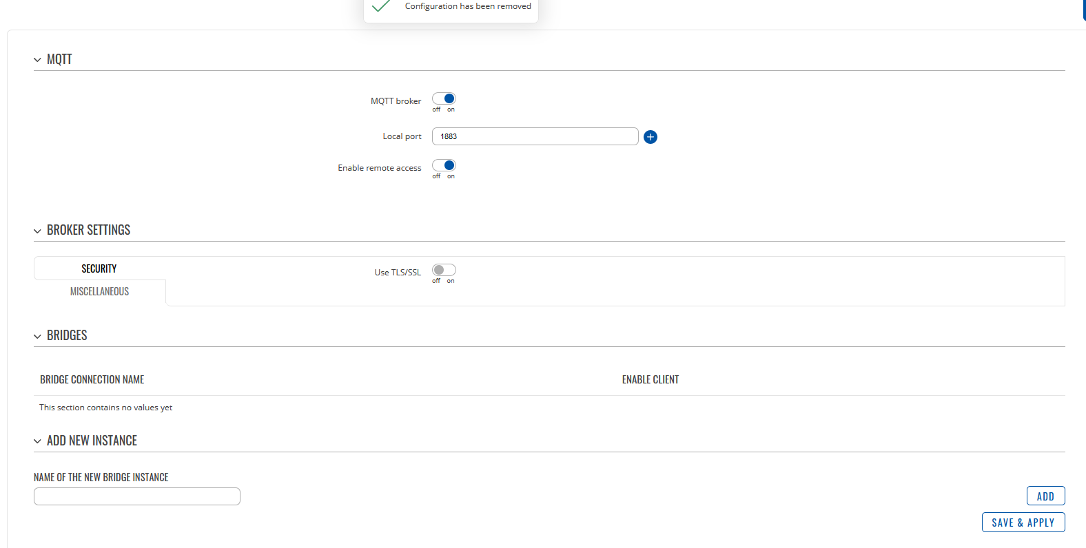

I have monitored the data to the MQTT broker on the RUT955 device and everything seems to work fine in that connection.
Here is a picture on the broker:

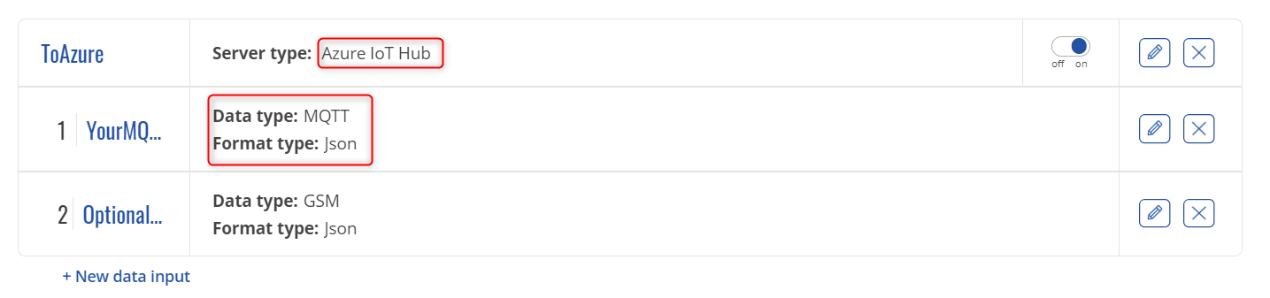

  • Download Azure package, but instead of configuring the package, configure data to server (you can achieve the same results with data to server now). In data to server, add MQTT data input which will connect to the broker on RUT and listen on a specific topic. In the collection settings, use Azure (Azure in cloud solutions needs to be disabled). This way, when a message on that topic is published to the broker on RUT, data to server will forward it to Azure.
    This option would also allow you to send additional data to Azure if needed (as additional data inputs).

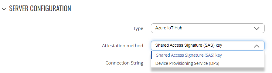

  • Also, in the server configuration (collection) for data to server, you can try using a different attestation method. Instead of SAS, you can try using DPS.
However, we do not have any wiki pages/examples for DPS option, so I suggest checking Microsoft’s page here.
