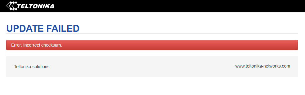

I have multiple RUT 955 Devices I need to update/unbrick.
I can get to the Bootloader 192.168.1.1/Index.html and upload a firmware file but I get a checksum error preventing me from performing the update.
I suspect I need to repair the bootloader as the Firmware files for these 955 files are official from Teltonika’s RUT955 Firmware repository. But I Cannot find any source files for the 955 bootloaders.
Thanks In Advanced.
From screenshot I can see you have legacy firmware. So try upload legacy firmware file ( RUT9XX_R_00.06.09.5_WEBUI.bin) and not newest available (RUT9_R_00.07.06.17_WEBUI.bin):
