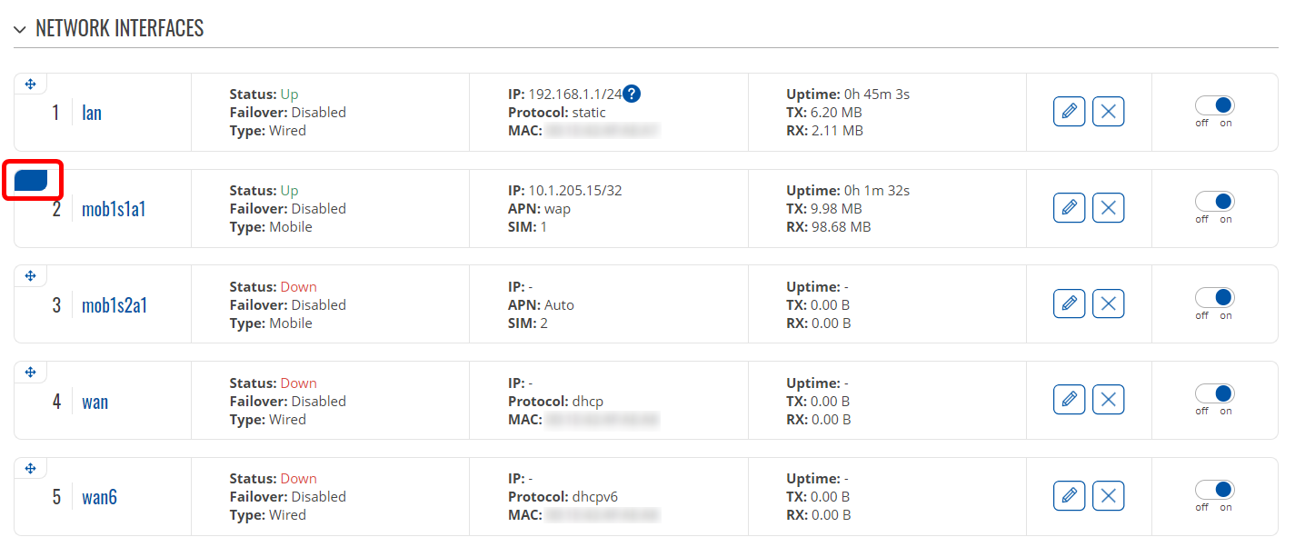

By default, WAN interface takes priority over SIM connection. This priority (metrics) can be changed by navigating to Network → Interfaces → General and dragging the mob1s1a1 interfaces above the wan and wan6 interfaces:

Thanks - all sorted. We use the router as a mobile access point at Sports events for video streaming, so it’s on/off a lot! Worked ok fine for five months then seemed to reorder the interfaces on its own! As you say, drag/drop facility is on the Fallover/Load Balancing page. Set mob1s1a1 to ‘online’ too.
