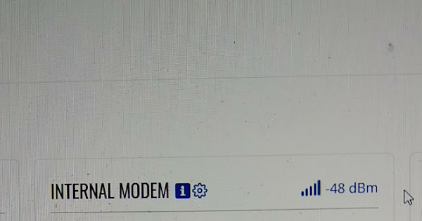

A: sending over a path to my google photo, where I shear a video of behave of 1 of the routers.
Attach also the system log is show below.
